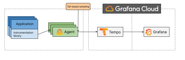

How tail-based sampling works
In tail-based sampling, sampling decisions are made at the end of the workflow allowing for a more accurate sampling decision. The Grafana Agent groups spans by trace ID and checks its data to see if it meets one of the defined policies (for example, latency or status_code). For instance, a policy can check if a trace contains an error or if it took longer than a certain duration.
A trace is sampled if it meets at least one policy.
To group spans by trace ID, the Agent buffers spans for a configurable amount of time, after which it considers the trace complete. Longer running traces are split into more than one. However, waiting longer times increases the memory overhead of buffering.
One particular challenge of grouping trace data is for multi-instance Agent deployments, where spans that belong to the same trace can arrive to different Agents. To solve that, you can configure the Agent to load balance traces across agent instances by exporting spans belonging to the same trace to the same instance.
This is achieved by redistributing spans by trace ID once they arrive from the application. The Agent must be able to discover and connect to other Agent instances where spans for the same trace can arrive. Kubernetes users should use a headless service.
Redistributing spans by trace ID means that spans are sent and received twice, which can cause a significant increase in CPU usage. This overhead increases with the number of Agent instances that share the same traces.
Tail-based sampling overview
