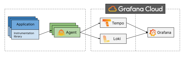

Running instrumented distributed systems is a very powerful way to gain understanding over a system, but it brings its own challenges. One of them is discovering which traces exist.
In the beginning of Tempo, querying for a trace was only possible if you knew
the ID of the trace you were looking for. One solution was automatic logging.
Automatic logging provides an easy and fast way of discovering trace IDs
through log messages. Well-formatted log lines are written to a Loki instance
or to stdout for each span, root, or process that passes through the tracing
pipeline. This allows for automatically building a mechanism for trace
discovery. On top of that, you can also get metrics from traces using Loki, and
allow quickly jumping from a log message to the trace view in Grafana.
