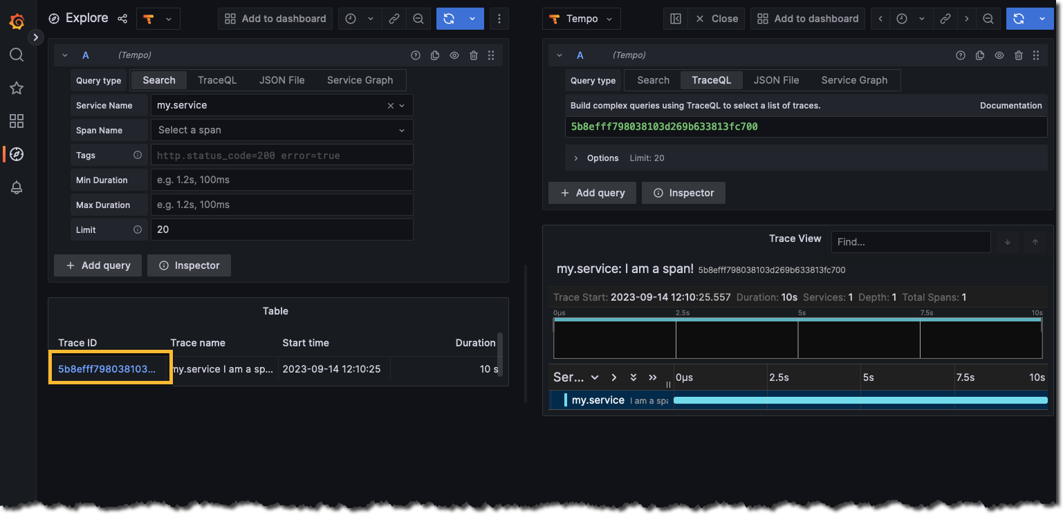

  1. View the trace in Grafana:
    1. Open a browser window to http://localhost:3000.
    2. Open the Explorer page and select the Tempo data source.
    3. Select the Search query type.
    4. Select Run query to list available traces.
    5. Select the trace ID (yellow box) to view details about the trace and its spans.
Using the TraceQL query builder on Explore to view pushed trace in Grafana.
