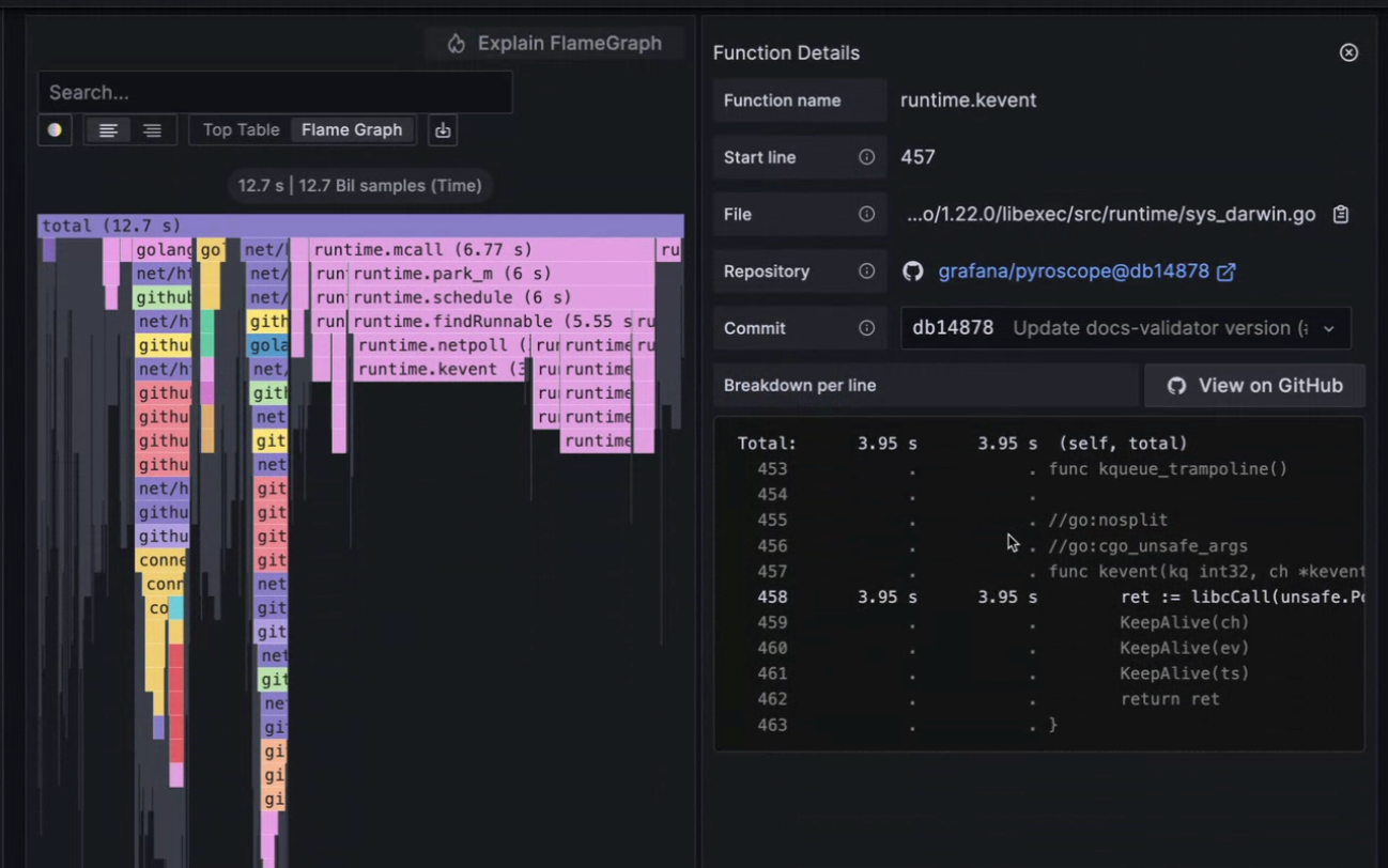

Example of a flame graph with the function details populated

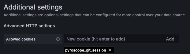

In order to make use of the GitHub integration, the Pyroscope data source needs to be configured to pass a particular cookie through.
To configure cookie passthrough in Grafana:
  1. Navigate to Configuration > Data sources in Grafana.
  2. Select your Pyroscope data source.
  3. Under Additional settings > Advanced HTTP settings , locate Allowed cookies.
  4. Add pyroscope_git_session to the list of cookies to forward.
  5. Click Save & test to apply the changes.
Additional data source settings for Pyroscope GitHub integration
Note
Cookie forwarding must be enabled for the GitHub integration to work properly. Without it, you won’t be able to connect to GitHub repositories from within Grafana Profiles Drilldown.

Function Details
The Function Details section provide information about the function you selected from the flame graph.
Function Details panel from a connected Pyroscope GitHub integration.
The table explains the main fields in the table. The values for some of the fields, such as Self and Total, change depending whether a profile uses time or memory amount. Refer to Understand Self versus Total metrics in profiling with Pyroscope for more information.
FieldMeaningNotes
Function nameThe name of the selected function
Start timeThe line where the function definition starts
FilePath where the function is definedYou can use the clipboard icon to copy the path.
RepositoryThe repository configured for the selected service
CommitThe version of the application (commit) where the function is defined. Use the drop-down menu to target a specific commit.Click the Commit ID to view the commit in the repository.
Breakdown per line (table)Provides the function location in the code and self and total values.
Selfβ€˜Self’ refers to the resource usage (CPU time, memory allocation, etc.) directly attributed to a specific function or a code segment, excluding the resources used by its sub-functions or callsThis value can be a time or memory amount depending on the profile selected.
Totalβ€˜Total’ encompasses the combined resource usage of a function along with all the functions it calls.This value can be a time or memory amount depending on the profile selected.
