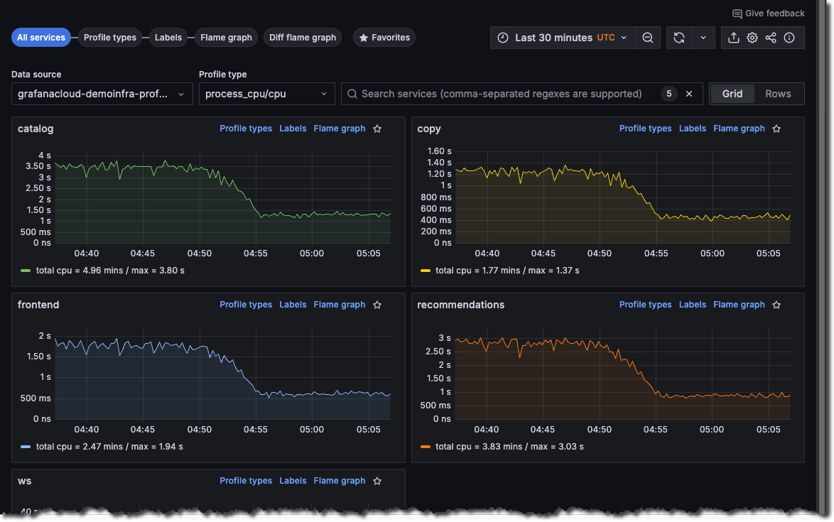

Profiles Drilldown provides an intuitive interface to specifically support these use cases. You get a holistic view of all of your services and how they’re functioning, but also the ability to drill down for more targeted root cause analysis.
Profiles Drilldown home screen
