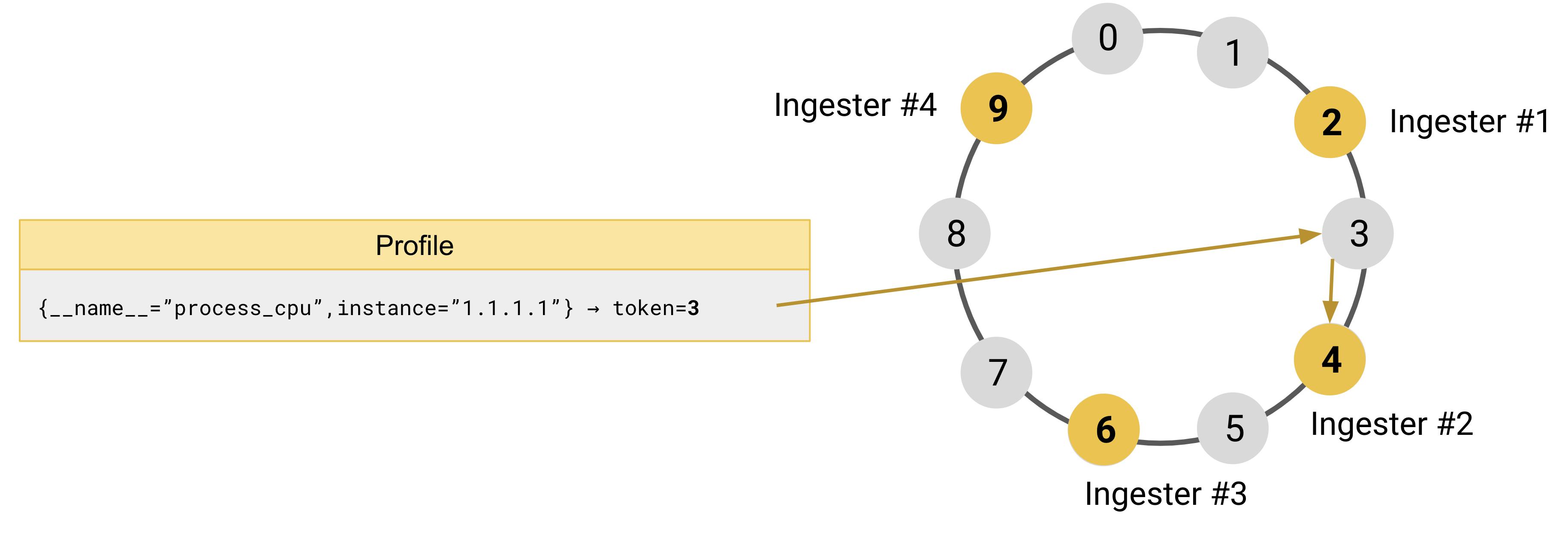

To better understand how it works, take four ingesters and a tokens space between 0 and 9 as an example:
  • Ingester #1 is registered in the ring with the token 2
  • Ingester #2 is registered in the ring with the token 4
  • Ingester #3 is registered in the ring with the token 6
  • Ingester #4 is registered in the ring with the token 9
Pyroscope receives an incoming performance profile with labels {__name__="process_cpu", instance="1.1.1.1"}. It hashes the profile’s labels, and the result of the hashing function is the token 3.
To find which ingester owns token 3, Pyroscope looks up the token 3 in the ring and finds the ingester that is registered with the smallest token larger than 3. The ingester #2, which is registered with token 4, is the authoritative owner of the profile {__name__="process_cpu",instance="1.1.1.1"}.
Hash ring without replication

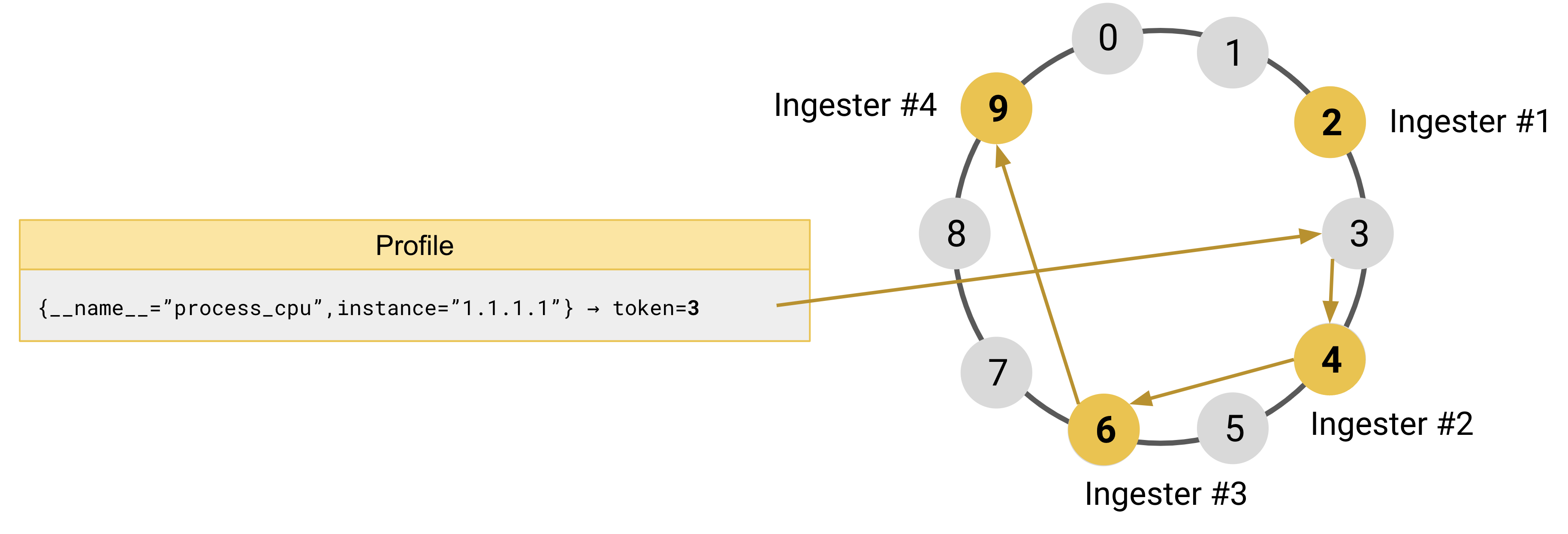

With replication set to 3, Pyroscope replicates each profile to three ingesters. After finding the authoritative owner of the profile, Pyroscope continues to walk the ring clockwise to find the remaining two instances where the profile should be replicated. In the example that follows, the profile is replicated to the instances of Ingester #3 and Ingester #4.
Hash ring with replication
