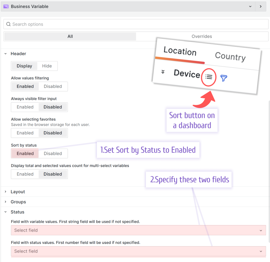

You can let users sort Business Variable panel values based on data retrieved from the data source.
To enable sorting, set Sort by Status to Enabled and specify:
  • Field with variable values: This field maps the data frame with the variable panel values.
  • Field with status values: This field must be numeric. The values are used for sorting.

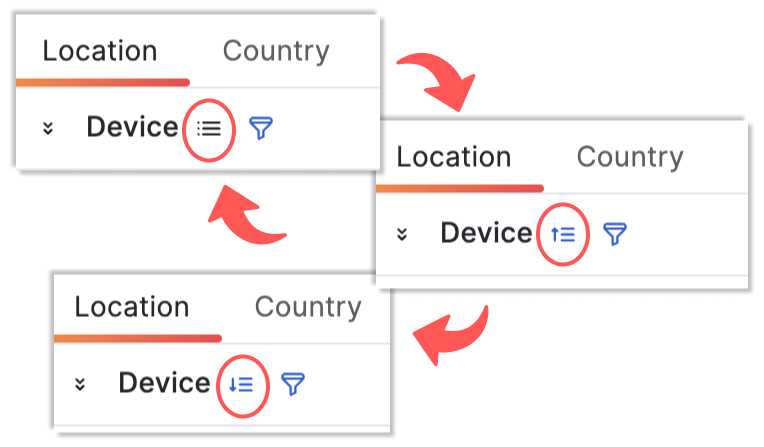

Sorting button configuration.
The sorting button alternates between three modes when you click it:
  • Neutral: The variable panel is in this state after the page loads and after each page refresh.
  • Descending
  • Ascending
Sorting button has three alternating by click modes.
