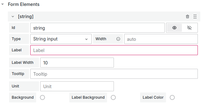

    The title or label of the element. Equivalent to the ‘Label’ in the UI editor.
Label field
  • labelWidth
    Number | null . Required.
    The element label width.

  • tooltip
    string. Required.
    The element tooltip. Leave as an empty string (’’) if not displayed.

  • unit
    string. Required.
    The units of measurement. Located to the right of the element. Leave as an empty string (’’) if the element has no unit.
Unit of measurement
  • background
    string. Optional.
    The background color as a hex color code.
  • labelBackground
    string. Optional. The label background color as a hex color code.
  • labelColor
    string. Optional.
    The label color as a hex color code.
