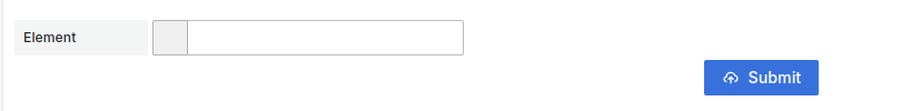

The Color Picker lets you select a color from a palette.
This element has the following specific option:
  • Color format: HEX or RGB
Color Picker element.
