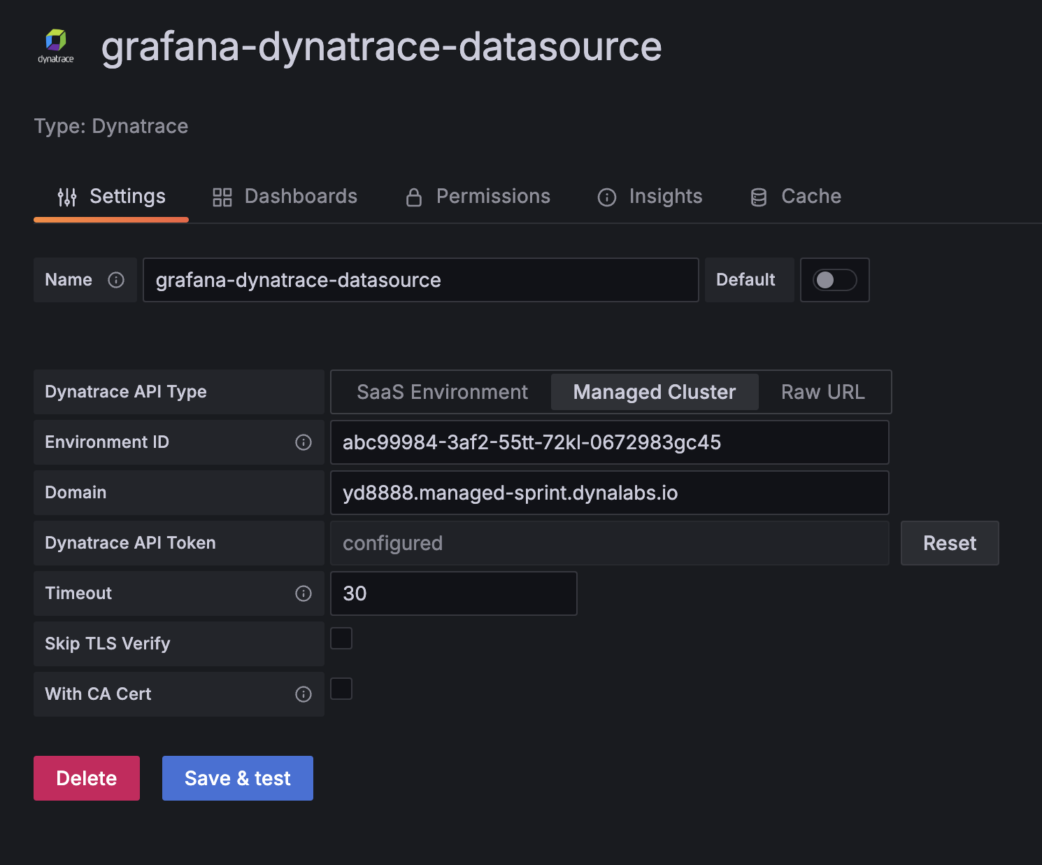

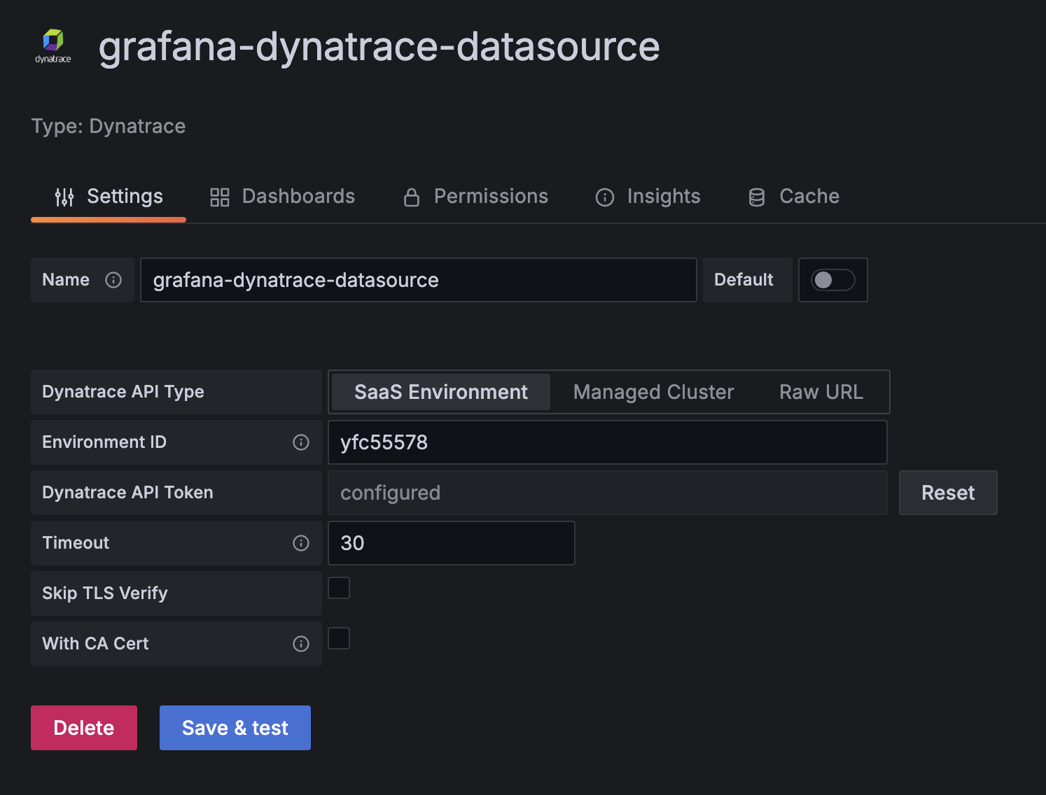

- Environment ID
- In the SaaS example of
yfc55578.live.dynatrace.com, your Environment ID would beyfc55578. In the Managed example ofyd8888.managed-sprint.dynalabs.io/e/abc99984-3af2-55tt-72kl-0672983gc45, your Environment ID would beabc99984-3af2-55tt-72kl-0672983gc45, and your Domain would beyd8888.managed-sprint.dynalabs.io

Configure the data source with provisioning
It is possible to configure data sources using config files with Grafana’s provisioning system. To read more about how configuration works, including all the settings that you can set for data sources, refer to Provisioning Grafana.
apiVersion: 1
datasources:
- name: Dynatrace
type: grafana-dynatrace-datasource
jsonData:
apiType: saas
environmentId: environment Id
secureJsonData:
apiToken: API token
- name: Dynatrace Managed
jsonData:
apiType: managed
environmentId: environment Id # example: abc99984-3af2-55tt-72kl-0672983gc45
domain: domain # example: yd8888.managed-sprint.dynalabs.io
tlsSkipVerify: false
tlsAuthWithCACert: true
httpClientTimeout: 360
secureJsonData:
apiToken: API token
tlsCACert: |
