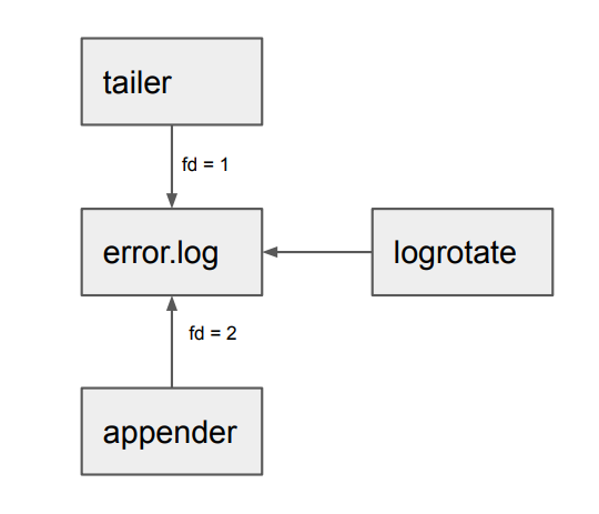

At any point in time, there may be three processes working on a log file as shown in the image below.
- Appender - A writer that keeps appending to a log file. This can be your application or some system daemons like Syslog, Docker log driver or Kubelet, etc.
- Tailer - A reader that reads log lines as they are appended, for example, agents like Promtail.
- Log Rotator - A process that rotates the log file either based on time (for example, scheduled every day) or size (for example, a log file reached its maximum size).
Note
Here
fd
defines a file descriptor. Once a file is open for read or write, The Operating System returns a unique file descriptor (usually an integer) per process, and all the operations like read and write are done over that file descriptor. In other words, once the file is opened successfully, the file descriptor matters more than the file name.

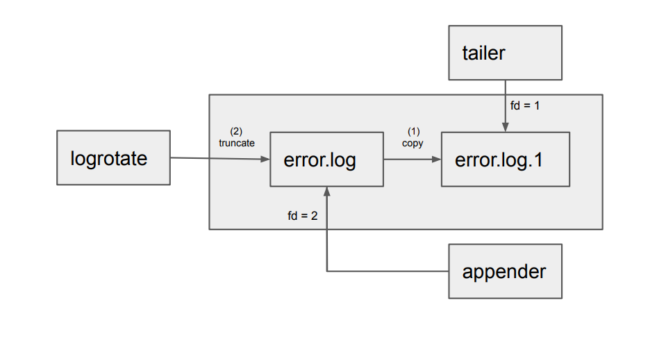

- Copy the log file with a different name, for example,
error.log.1
and truncate the original log fileerror.log

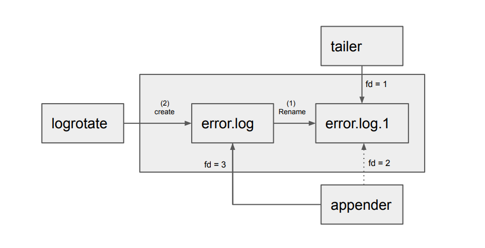

. - Rename the log file with a different name, for example,
error.log.1
and create a new log file with the original nameerror.log
In both cases, after log rotation, all new log lines are written to the original error.log
file.

Copy and Truncate(1) favors the appender
as its descriptor for the original log file error.log
doesn’t change. Therefore, it can keep writing to the same file descriptor. In other words, re-opening the file is not needed.
However, (1) has a serious problem when considering the tailer
. There is a race between truncating the file and the tailer
finishing reading that log file. Meaning, there is a high chance of the log rotation mechanism truncating the file error.log
before the tailer
reads everything from it.
This is where Rename and Create(2) can help. Here, when the log file error.log
is renamed to error.log.1
, the tailer
still holds the file descriptor of error.log.1
. Therefore, it can continue reading the log file until it is completed. But that comes with the tradeoff: with (2), you have to signal the appender
to reopen error.log
(and appender
should be able to reopen it). Otherwise, it would keep writing to error.log.1
as the file descriptor won’t change. The good news is that most of the popular appender
solutions (for example, Syslog, Kubelet, Docker log driver) support reopening log files when they are renamed.
We recommend Rename and Create(2) as that is the method which works well with Promtail (or any similar log scraping agent) without any data loss. Now let’s understand exactly how we configure log rotation in different platforms.
