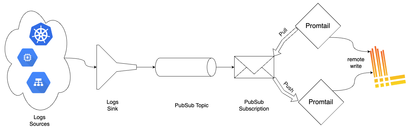

There’s two flavours of how to configure this:
  • Pull-based subscription: Promtail pulls log entries from a GCP PubSub topic
  • Push-based subscription: GCP sends log entries to a web server that Promtail listens
Overall, the setup between GCP, Promtail and Loki will look like the following:
