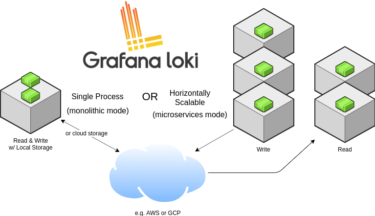

Modes of Operation
Loki has a set of components (defined below in Components) which are internally referred to as modules. Each component spawns a gRPC server for internal traffic and an HTTP/1 server for external API requests. All components come with an HTTP/1 server, but most only expose readiness, health, and metrics endpoints.
Which component Loki runs is determined by either the -target flag at the
command line or the target: <string> section in Loki’s config file. When the
value of target is all, Loki will run all of its components in a single
process. This is referred to as “single process”, “single binary”, or monolithic
mode. Monolithic mode is the default deployment of Loki when Loki is installed
using Helm.
When target is not set to all (i.e., it is set to querier, ingester,
query-frontend, or distributor), then Loki is said to be running in “horizontally scalable”,
or microservices, mode.
Each component of Loki, such as the ingesters and distributors, communicate with one another over gRPC using the gRPC listen port defined in the Loki config. When running components in monolithic mode, this is still true: each component, although running in the same process, will connect to each other over the local network for inter-component communication.
Single process mode is ideally suited for local development, small workloads, and for evaluation purposes. Monolithic mode can be scaled with multiple processes with the following limitations:
- Local index and local storage cannot currently be used when running monolithic mode with more than one replica, as each replica must be able to access the same storage backend, and local storage is not safe for concurrent access.
- Individual components cannot be scaled independently, so it is not possible to have more read components than write components.
