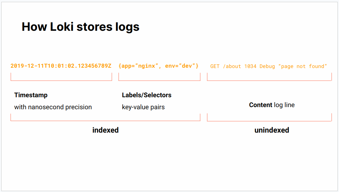

A Loki log consists of:
  • a timestamp
  • labels/selectors
  • content of the log line.
Loki indexes the timestamp and labels, but not the rest of the log line.
