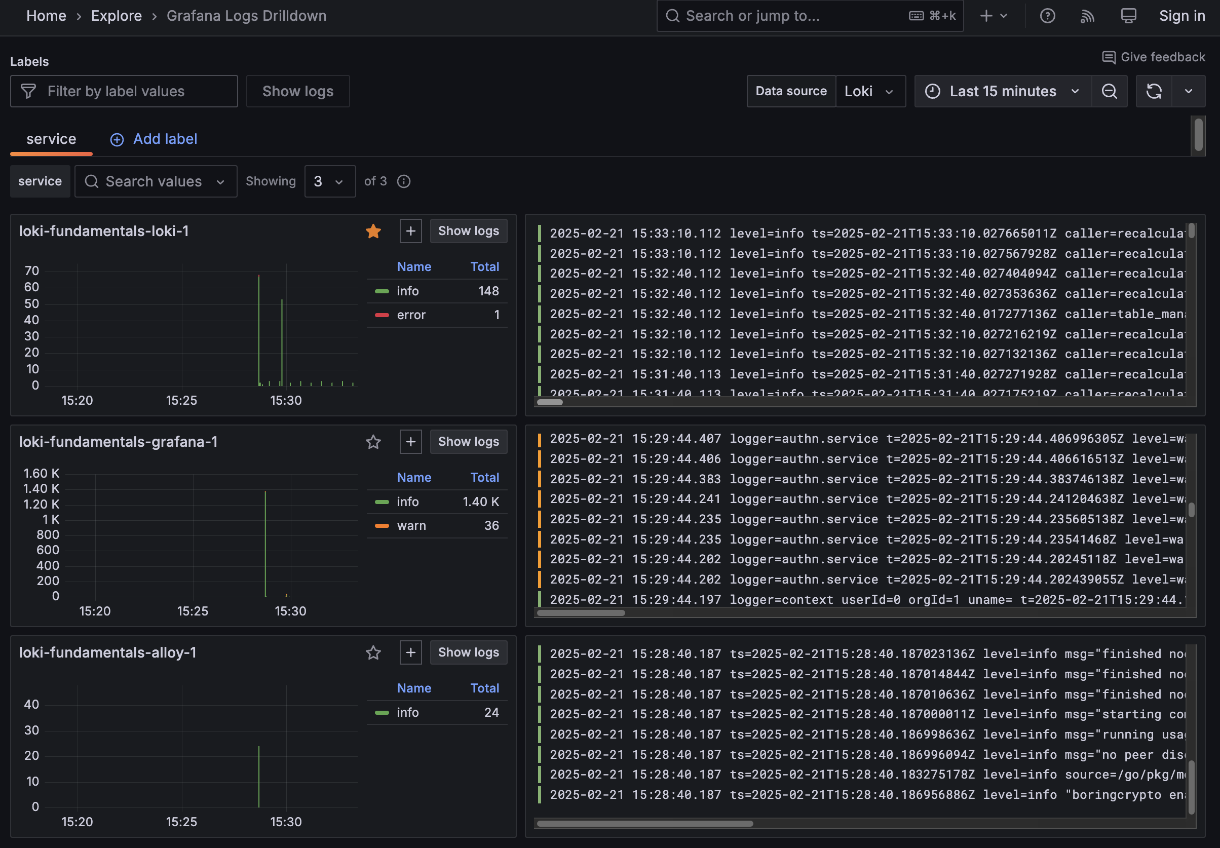

Since Grafana Alloy is configured to tail logs from all Docker containers, Loki should already be receiving logs. The best place to verify log collection is using the Grafana Logs Drilldown feature. To do this, navigate to http://localhost:3000/drilldown. Select Logs. You should see the Grafana Logs Drilldown page.
If you have only the getting started demo deployed in your Docker environment, you should see three containers and their logs; loki-fundamentals-alloy-1, loki-fundamentals-grafana-1 and loki-fundamentals-loki-1. In the loki-fundamentals-loki-1 container, click Show Logs to drill down into the logs for that container.

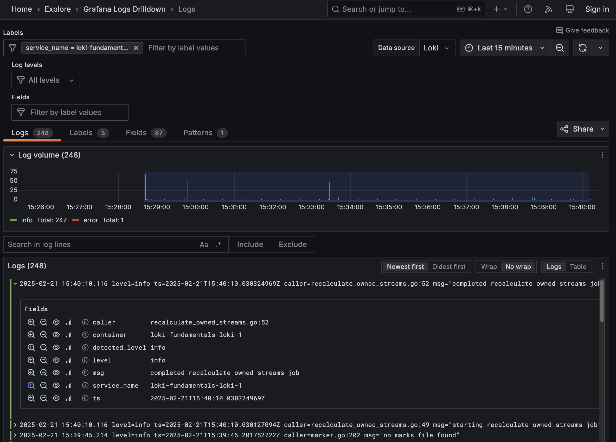

Grafana Drilldown Service View
We will not cover the rest of the Grafana Logs Drilldown features in this quickstart guide. For more information on how to use the Grafana Logs Drilldown feature, refer to Get started with Grafana Logs Drilldown.

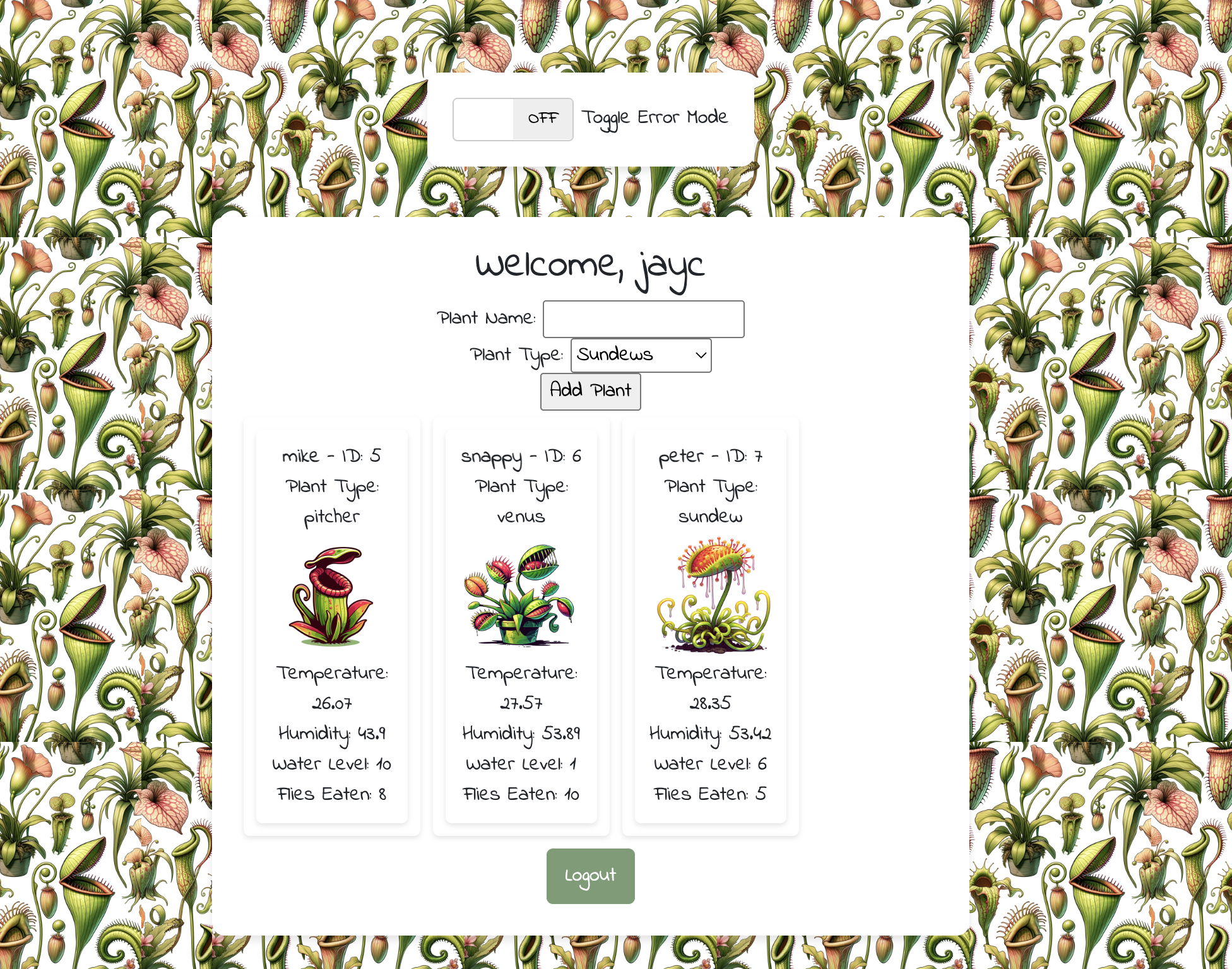

    Now that the sample application is running, run some actions in the application to generate logs. Here is a list of actions:
    1. Create a user: Click Sign Up and create a new user. Add a username and password and click Sign Up.
    2. Login: Use the username and password you created to login. Add the username and password and click Login.
    3. Create a plant: Once logged in, give your plant a name, select a plant type and click Add Plant. Do this a few times if you like.
Your greenhouse should look something like this:
Greenhouse Dashboard

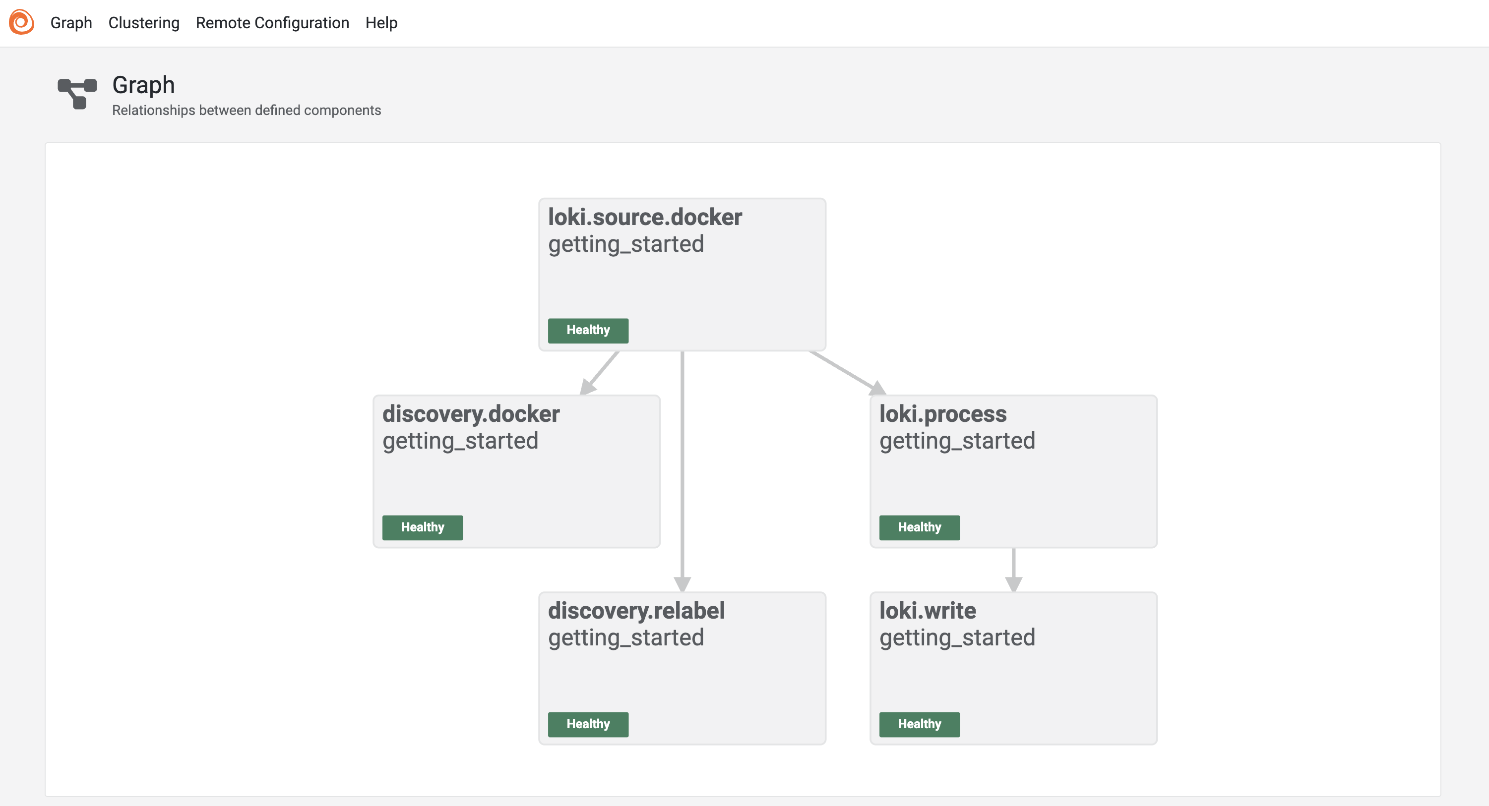

This configuration file can be viewed visually via the Alloy UI at http://localhost:12345/graph.
Alloy UI
Alloy UI
In this view you can see the components of the Alloy configuration file and how they are connected:
  • discovery.docker: This component queries the metadata of the Docker environment via the Docker socket and discovers new containers, as well as providing metadata about the containers.
  • discovery.relabel: This component converts a metadata (__meta_docker_container_name) label into a Loki label (container).
  • loki.source.docker: This component collects logs from the discovered containers and forwards them to the next component. It requests the metadata from the discovery.docker component and applies the relabeling rules from the discovery.relabel component.
  • loki.process: This component provides stages for log transformation and extraction. In this case it adds a static label env=production to all logs.
  • loki.write: This component writes the logs to Loki. It forwards the logs to the Loki endpoint http://loki:3100/loki/api/v1/push.
