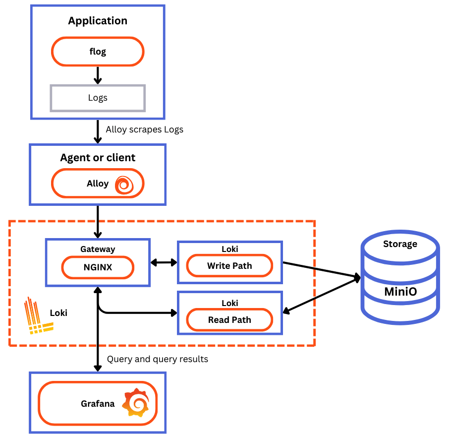

If you want to experiment with Loki, you can run Loki locally using the Docker Compose file that ships with Loki. It runs Loki in a monolithic deployment mode and includes a sample application to generate logs.
The Docker Compose configuration runs the following components, each in its own container:
  • flog: which generates log lines. flog is a log generator for common log formats.
  • Grafana Alloy: which scrapes the log lines from flog, and pushes them to Loki through the gateway.
  • Gateway (nginx) which receives requests and redirects them to the appropriate container based on the request’s URL.
  • Loki read component: which runs a Query Frontend and a Querier.
  • Loki write component: which runs a Distributor and an Ingester.
  • Loki backend component: which runs an Index Gateway, Compactor, Ruler, Bloom Planner (experimental), Bloom Builder (experimental), and Bloom Gateway (experimental).
  • Minio: which Loki uses to store its index and chunks.
  • Grafana: which provides visualization of the log lines captured within Loki.
