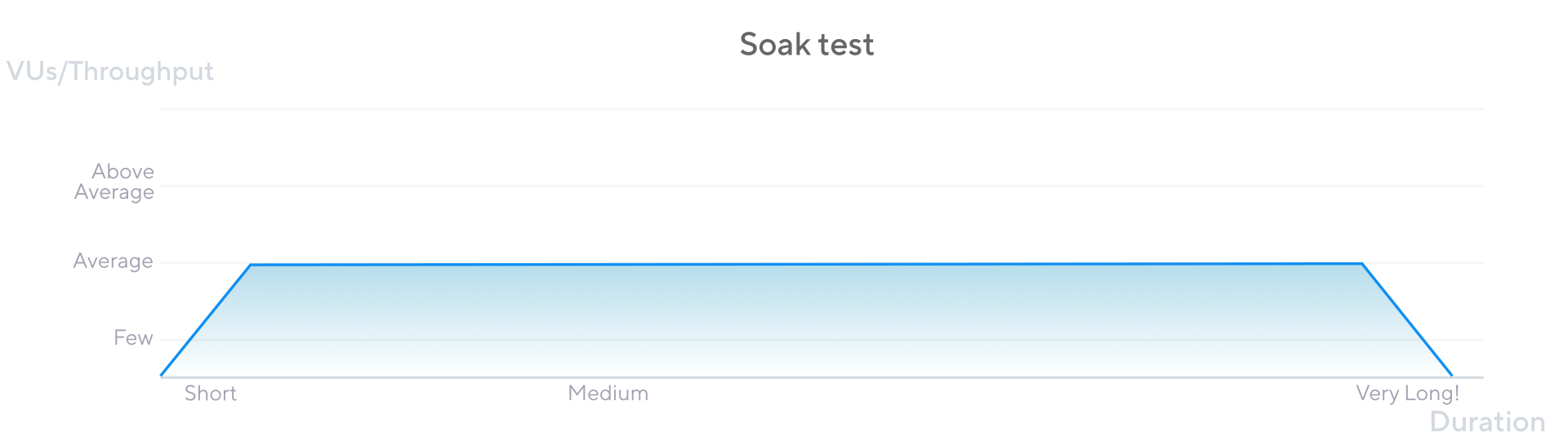

The soak test differs from an average-load test in test duration. In a soak test, the peak load duration (usually an average amount) extends several hours and even days. Though the duration is considerably longer, the ramp-up and ramp-down periods of a soak test are the same as an average-load test.
Overview of a soak test
In some testing conversation, a soak test might be called an endurance, constant high load, or stamina test.

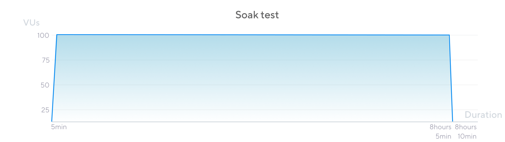

Notice that, as in an average-load test, peak load plateaus at 100. VUs. The difference is in duration. In this soak, peak load maintains for 8 hours rather than some minutes.
The shape of the soak test as configured in the preceding script
