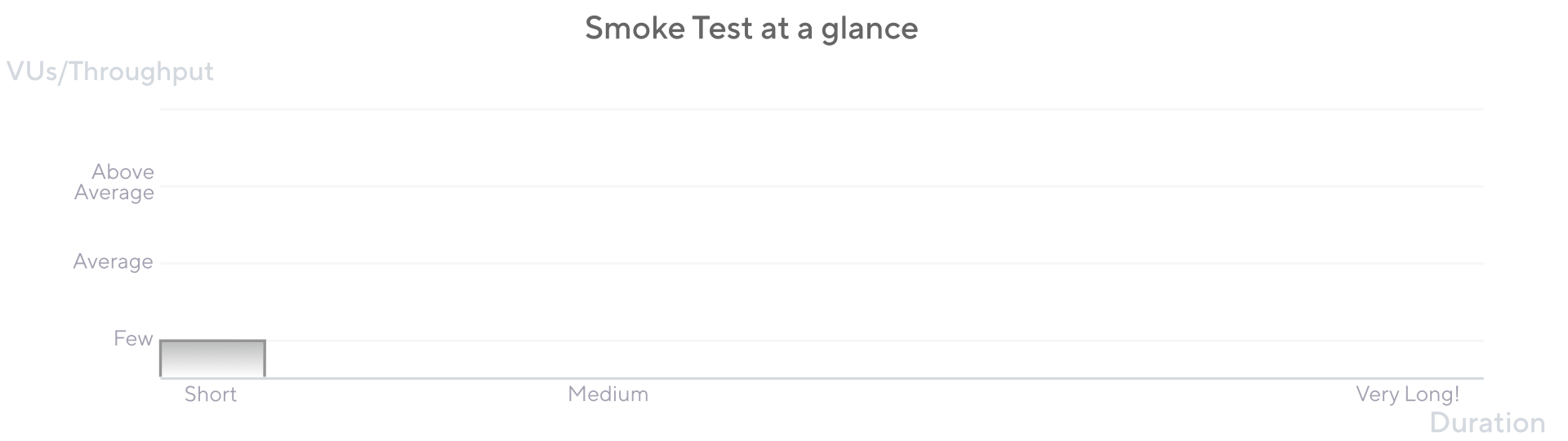

Overview of a smoke test
In some testing conversation, smoke tests are also called shakeout tests.

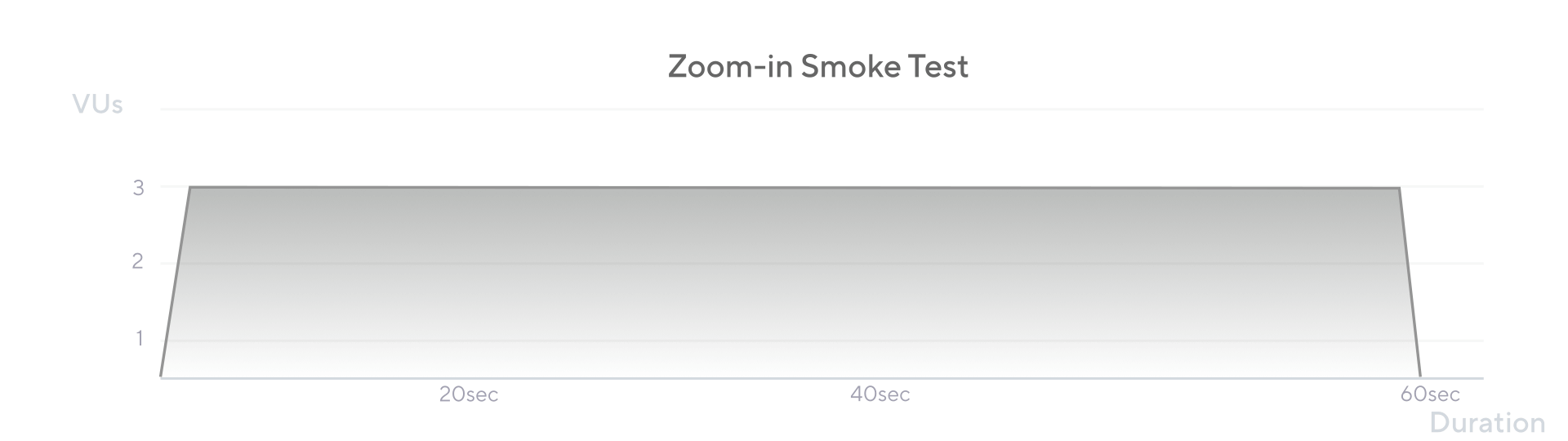

The following script is an example smoke test. You can copy it, change the endpoints, and start testing. For more comprehensive test logic, refer to Examples. The VU chart of a smoke test should look similar to this.
The shape of the smoke test as configured in the preceding script
