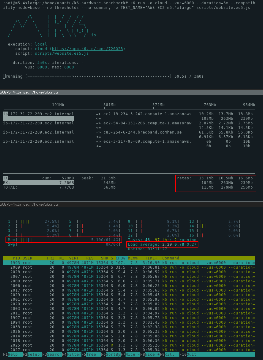

Monitoring the load generator
The previous section described how hardware limits the load your machine can generate. Keeping this in mind, you should monitor resources while the test runs—especially when running tests for the first time.
The easiest way to monitor the load generator is to open multiple terminals on the machine: one to run k6, and others to monitor the CPU, memory, and network. We recommend the following tools:
If you prefer graphical applications, use the system monitoring tool from your OS (e.g. GNOME System Monitor or Plasma System Monitor), or standalone tools like SysMonTask.
Here’s a screenshot of 3 terminal sessions showing k6, iftop and htop. k6 iftop htop
Monitoring guidelines
As the test runs, these are good indicators to monitor:
  • CPU utilization stays within 80%. If all CPU cores are 100% utilized during the test run, you might notice performance degradation in your test results.
  • Network utilization is at an acceptable level. Depending on your test, you might expect to fully saturate the network bandwidth, or this might be a signal that your test is bound by the available bandwidth. In other scenarios, you might want to minimize network usage to keep costs down.
  • Memory utilization doesn’t exceed 90%. If you’re close to exhausting available physical RAM, the system might start swapping memory to disk, which will affect performance and system stability (note that we recommend disabling swap space altogether). In extreme cases, running out of memory on Linux will cause the system to end the k6 process.
