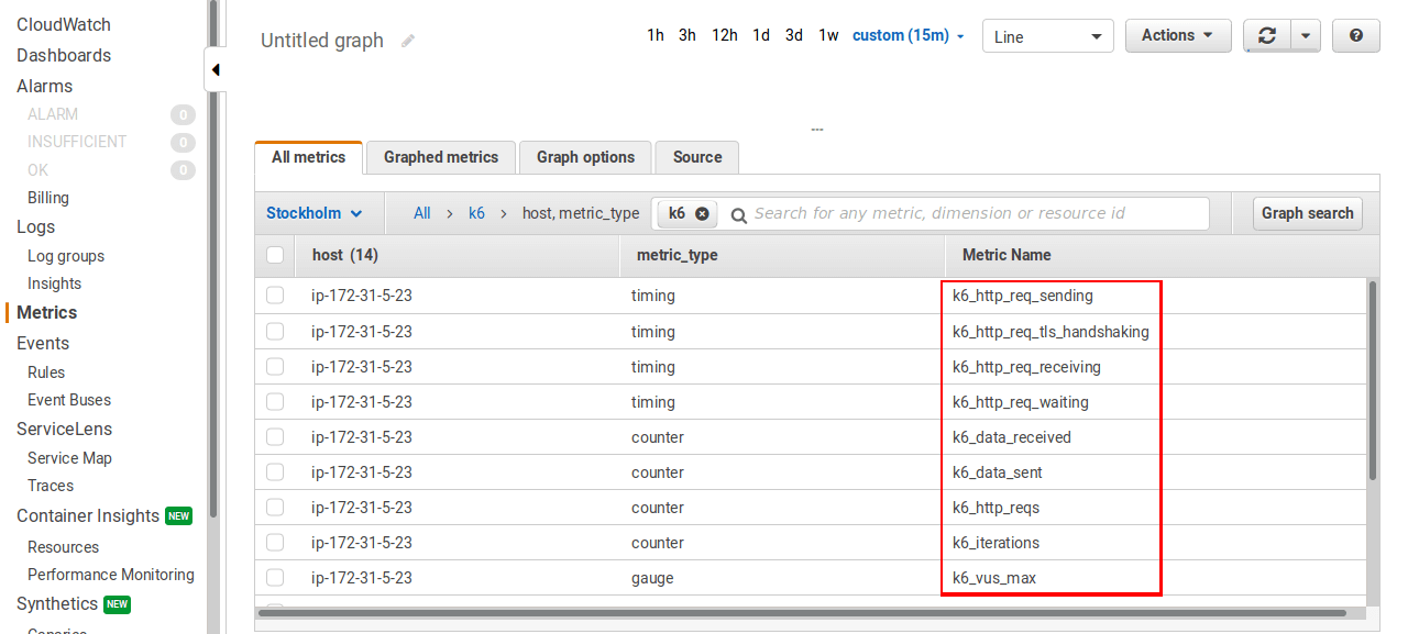

Visualize k6 metrics in Amazon CloudWatch
Visualization of the exported metrics to CloudWatch is done by creating a dashboard and selecting desired metrics to be displayed.
List of k6 metrics

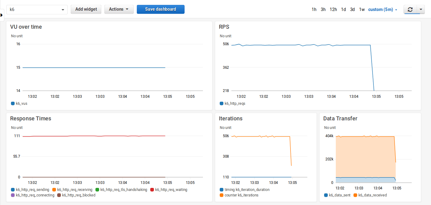

Here’s an example dashboard we’ve created to visualize the test results.
k6 Dashboard on Amazon CloudWatch
The above dashboard is exported as JSON and is available here.
