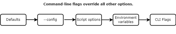

Order of precedence
Options passed as command-line flags override all other options: defaults < script options < environment variables < command-line flags
You can set options in multiple places. If there are conflicts, k6 uses the option from the place with the highest order of precedence.
  1. First, k6 uses the option’s default value.
  2. Next, k6 uses the options set in a configuration file via the --config flag.
  3. Then, k6 uses the script value (if set).
  4. After, k6 uses the environment variable (if set).
  5. Finally, k6 takes the value from the CLI flag (if set).
That is, command-line flags have the highest order of precedence.
