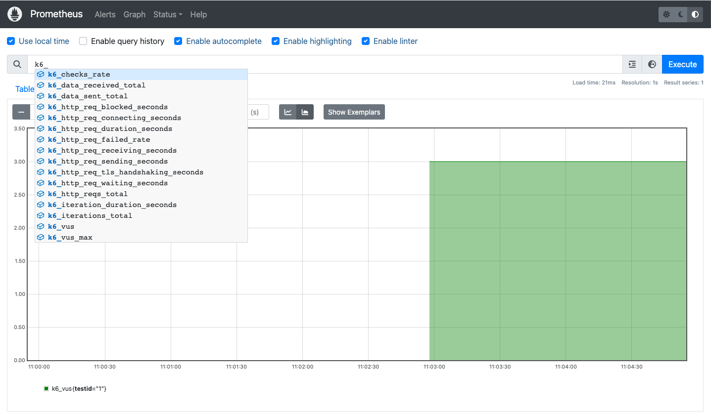

When running the previous k6 run commands, k6 starts sending time-series metrics to Prometheus. All the time series have a k6_ prefix. In the Prometheus Web UI, they appear like this:
k6 metrics as seen in the Prometheus UI

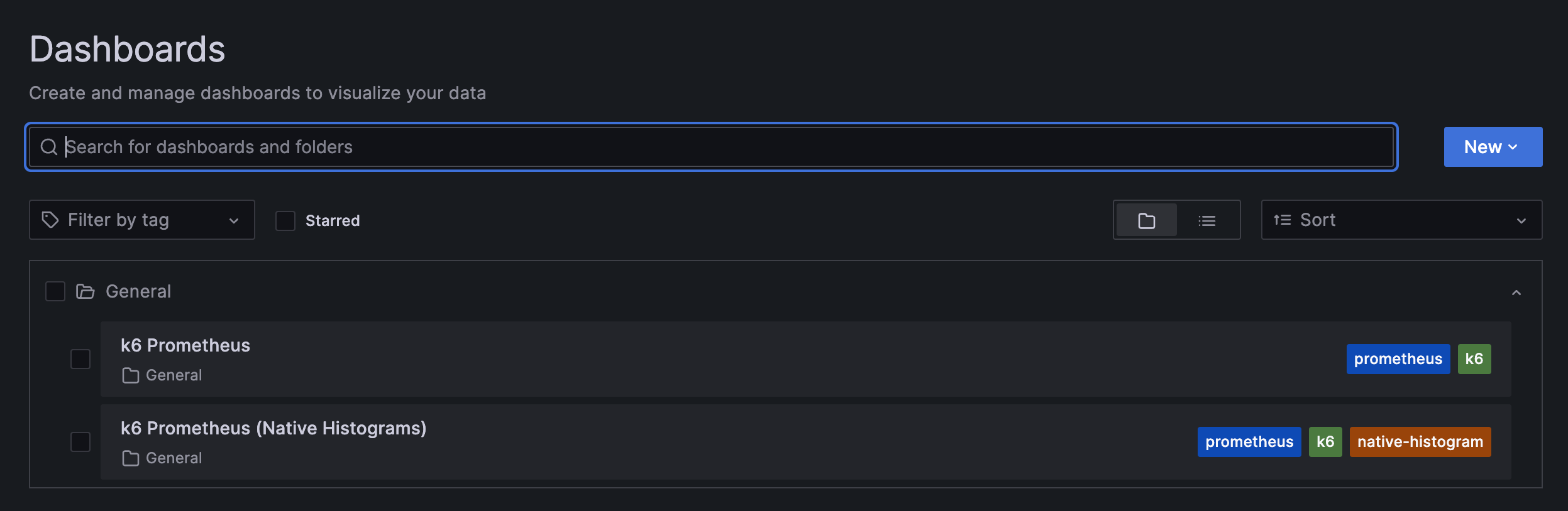

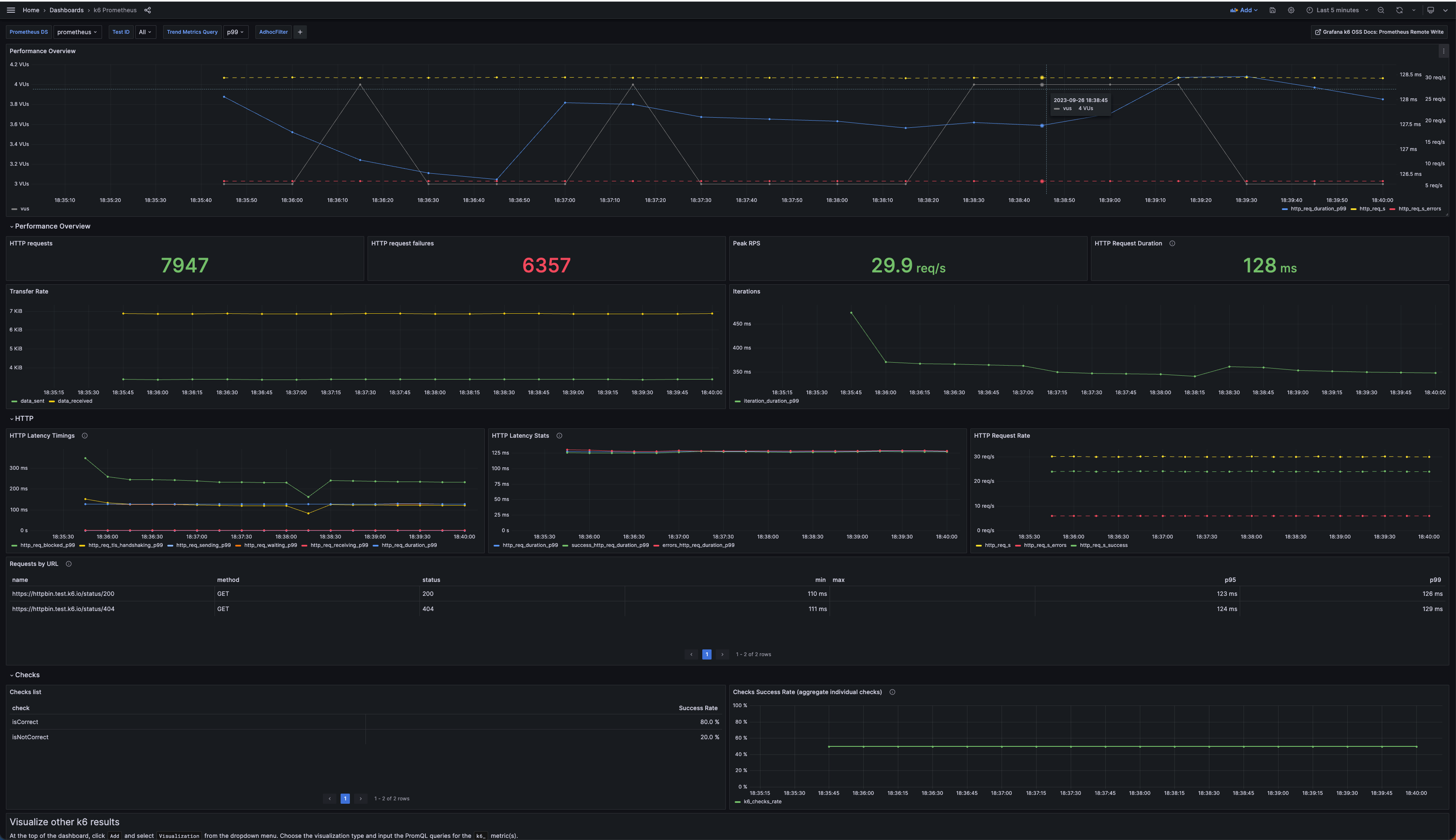

  3. After running the test, visit http://localhost:3000. If you enabled native histograms, select the k6 Prometheus (Native Histograms) dashboard; otherwise, select the k6 Prometheus Dashboard.
