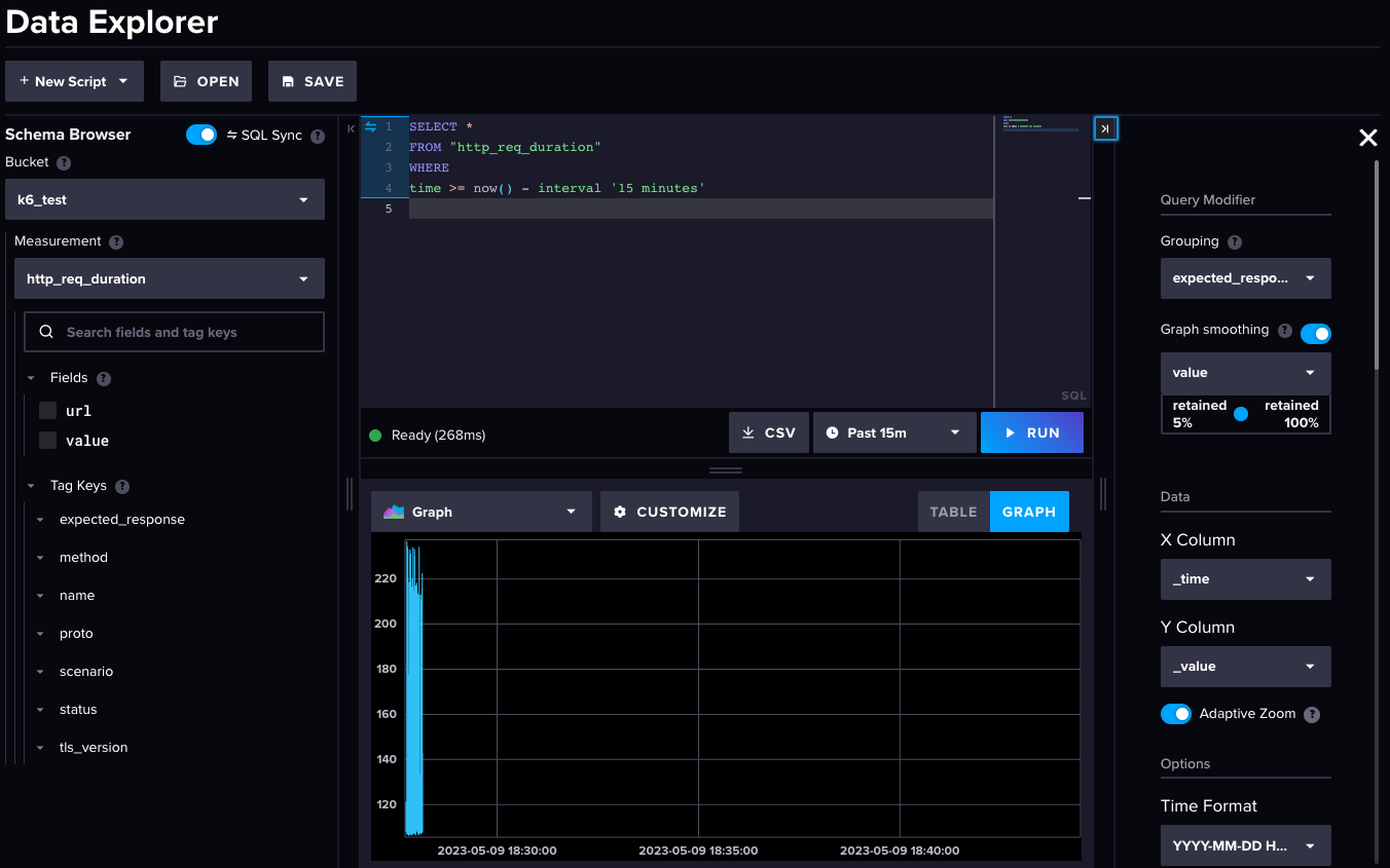

./k6 run script.js -o xk6-influxdbk6 runs the test script and sends the k6 metrics in real-time to the InfluxDB instance. You can now select the bucket to query and visualize the stored k6 metrics, for example, using the InfluxDB Data Explorer.
