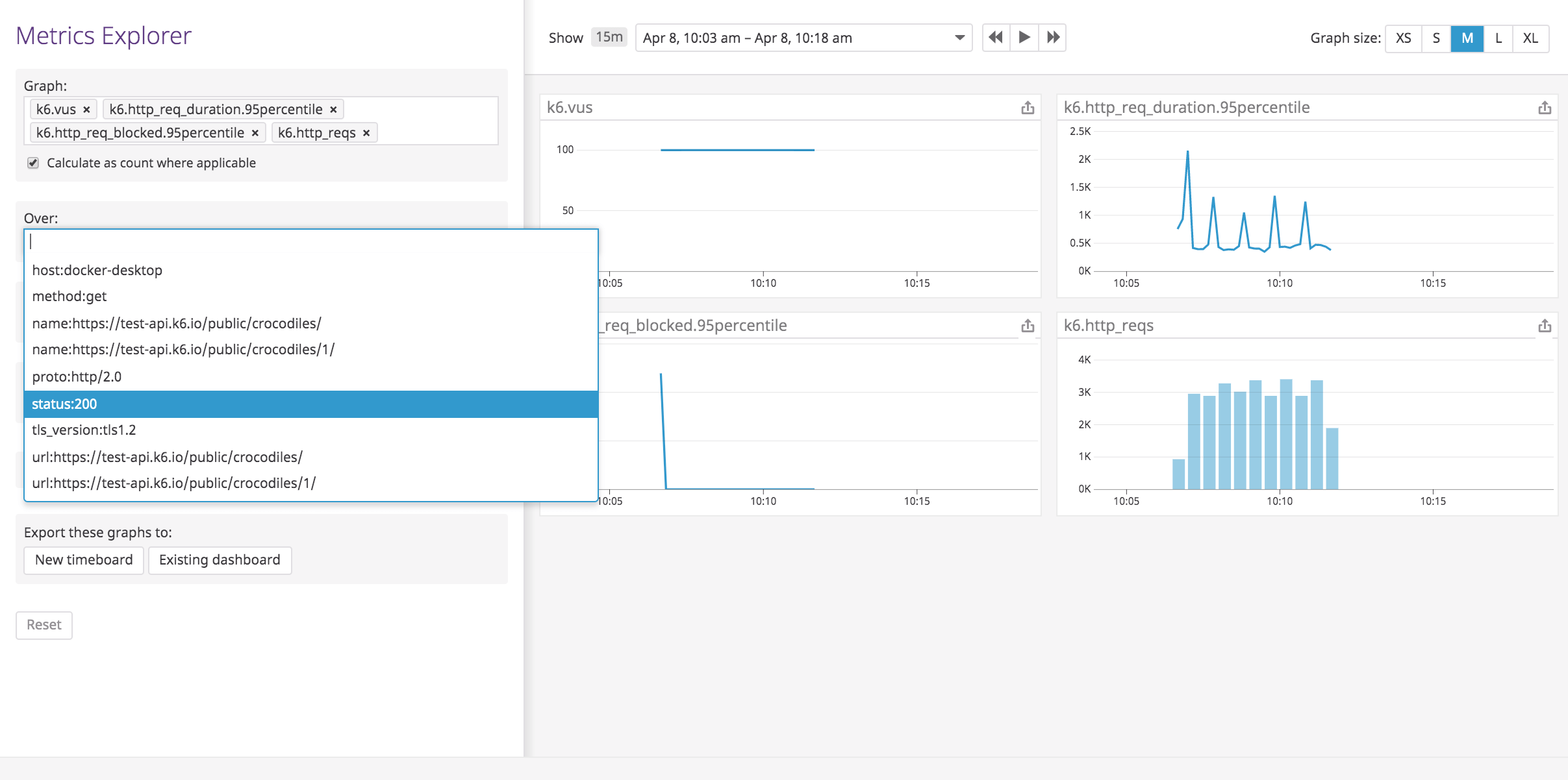

While running the test, k6 sends metrics periodically to Datadog. By default, these metrics have k6. as the name prefix.
You can visualize k6 metrics in real-time with the metrics explorer, monitors, or custom dashboards.
Datadog visualizing performance testing metrics
To learn more about all the types of k6 metrics, read the k6 Metrics guide

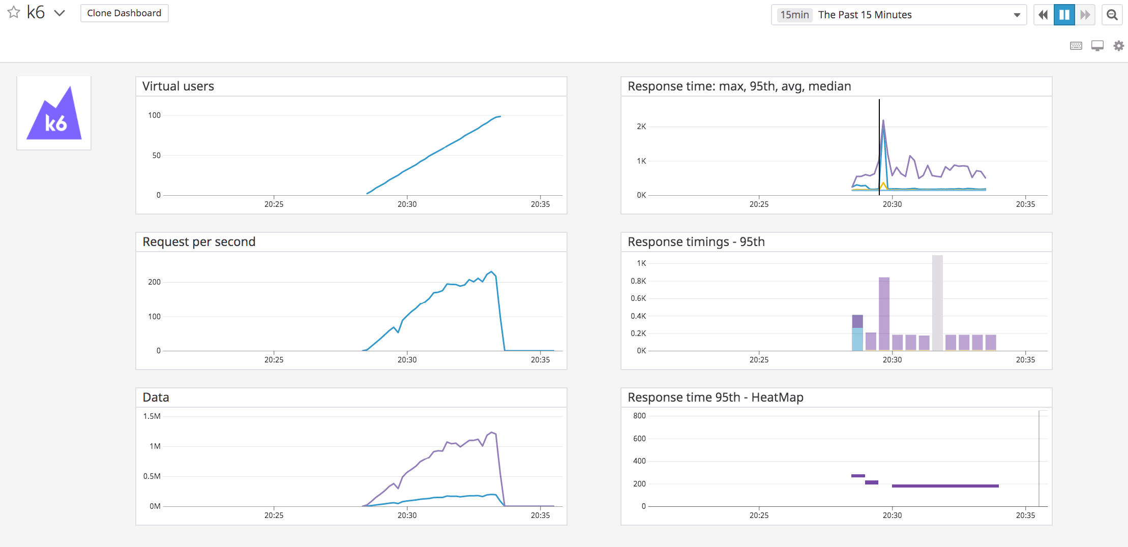

The first time Datadog detects the k6.http_reqs metric, the k6 integration tile is installed automatically, and the default k6 dashboard is added to your dashboard list.
k6 Datadog Dashboard
