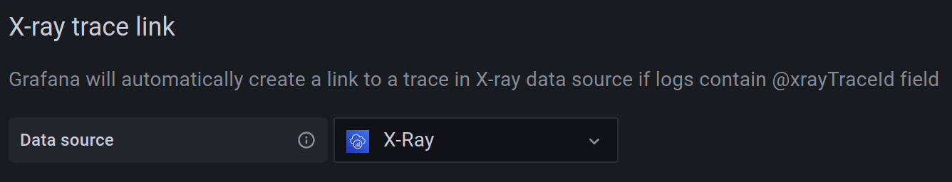

X-Ray trace links

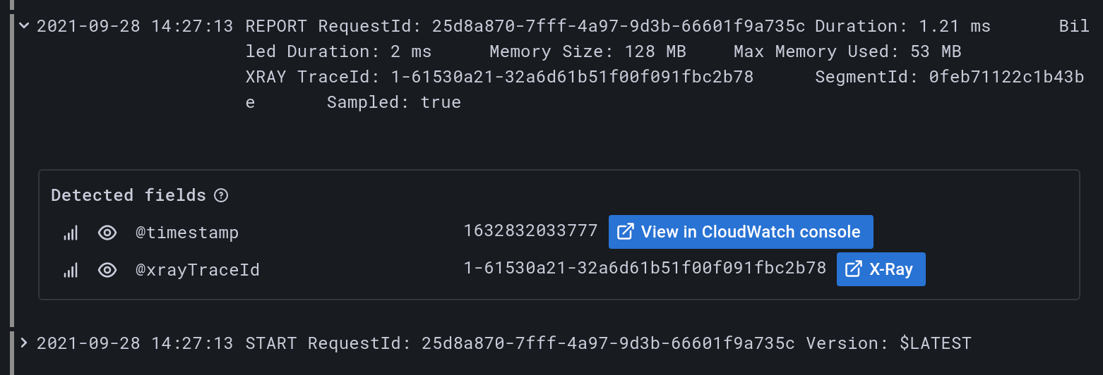

To automatically add links in your logs when the log contains the @xrayTraceId field, link an X-Ray data source in the “X-Ray trace link” section of the data source configuration.
The data source select contains only existing data source instances of type X-Ray. To use this feature, you must already have an X-Ray data source configured. For details, see the X-Ray data source docs.
To view the X-Ray link, select the log row in either the Explore view or dashboard Logs panel to view the log details section.
To log the @xrayTraceId, see the AWS X-Ray documentation.
To provide the field to Grafana, your log queries must also contain the @xrayTraceId field, for example by using the query fields @message, @xrayTraceId.

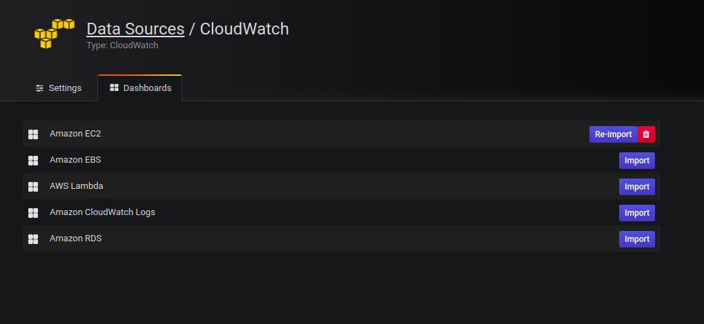

Import pre-configured dashboards
The CloudWatch data source ships with curated and pre-configured dashboards for five of the most popular AWS services:
- Amazon Elastic Compute Cloud:
Amazon EC2 - Amazon Elastic Block Store:
Amazon EBS - AWS Lambda:
AWS Lambda - Amazon CloudWatch Logs:
Amazon CloudWatch Logs - Amazon Relational Database Service:
Amazon RDS
To import curated dashboards:
Navigate to the data source’s configuration page.
Select the Dashboards tab.
This displays the curated selection of importable dashboards.
Select Import for the dashboard to import.
