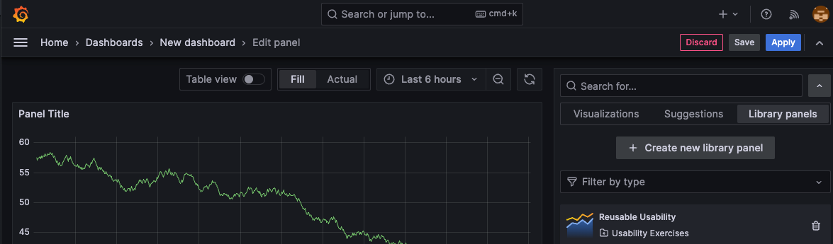

  1. Open a panel in edit mode.
  2. In the panel display options, click the down arrow option to bring changes to the visualization.
  3. Click Library panels, and then click + Create library panel to open the create dialog.
  4. In Library panel name, enter the name.
  5. In Save in folder, select the folder to save the library panel.
  6. Click Create library panel to save your changes.
  7. Save the dashboard.
Once created, you can modify the library panel using any dashboard on which it appears. After you save the changes, all instances of the library panel reflect these modifications.

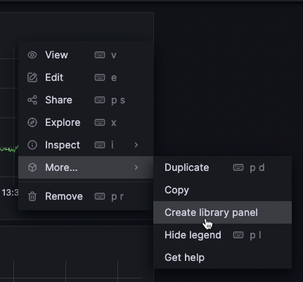

You can also create a library panel directly from the edit menu of any panel.
