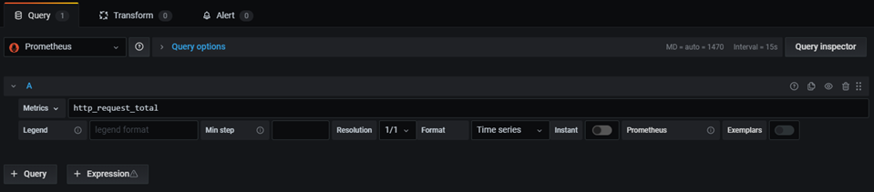

Prometheus (PromQL) query editor
![](/static/img/docs/queries/prometheus-query-editor-7-4.png)
