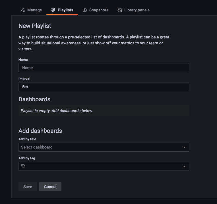

    Create a playlist
    You can create a playlist to present dashboards in a sequence, with a set order and time interval between dashboards.
    1. In the playlist page, click New playlist. The New playlist page opens.
    2. In the Name text box, enter a descriptive name.
    3. In the Interval text box, enter a time interval. Grafana displays a particular dashboard for the interval of time specified here before moving on to the next dashboard.
    4. In Dashboards, add existing dashboards to the playlist using Add by title and Add by tag drop-down options. The dashboards you add are listed in a sequential order.
    5. If needed:
      • Search for a dashboard by its name, a regular expression, or a tag.
      • Filter your results by starred status or tags.
    6. If needed, rearrange the order of the dashboard you have added using the up and down arrow icon.
    7. Optionally, remove a dashboard from the playlist by clicking the x icon beside dashboard.
    8. Click Save.
