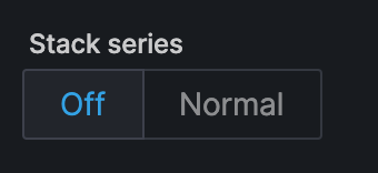

Stack series
Turn series stacking on or off.
Stack series editor

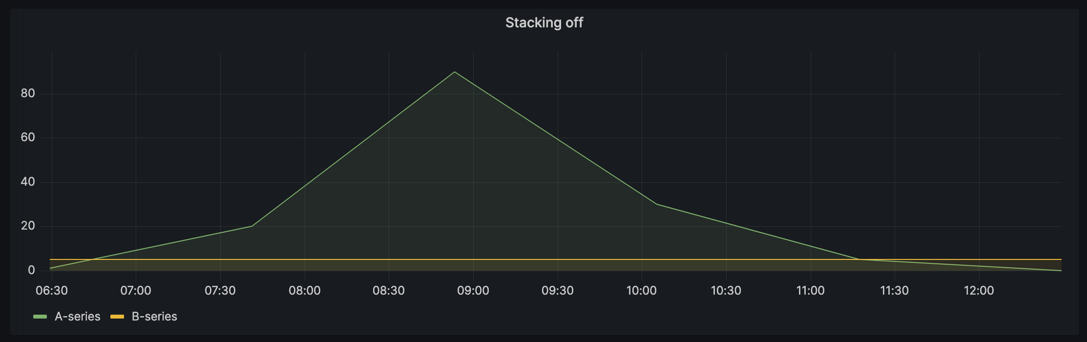

Off
Turn off series stacking. A series will share the same space in the visualization.
No series stacking example

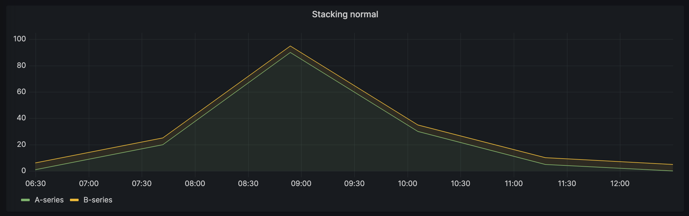

Normal
Enable stacking series on top of each other.
Normal series stacking example

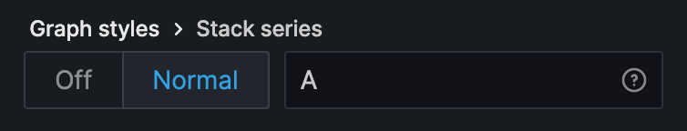

Stack series in groups
The stacking group option is only available as an override.
For more information about creating field overrides, refer to About field overrides.

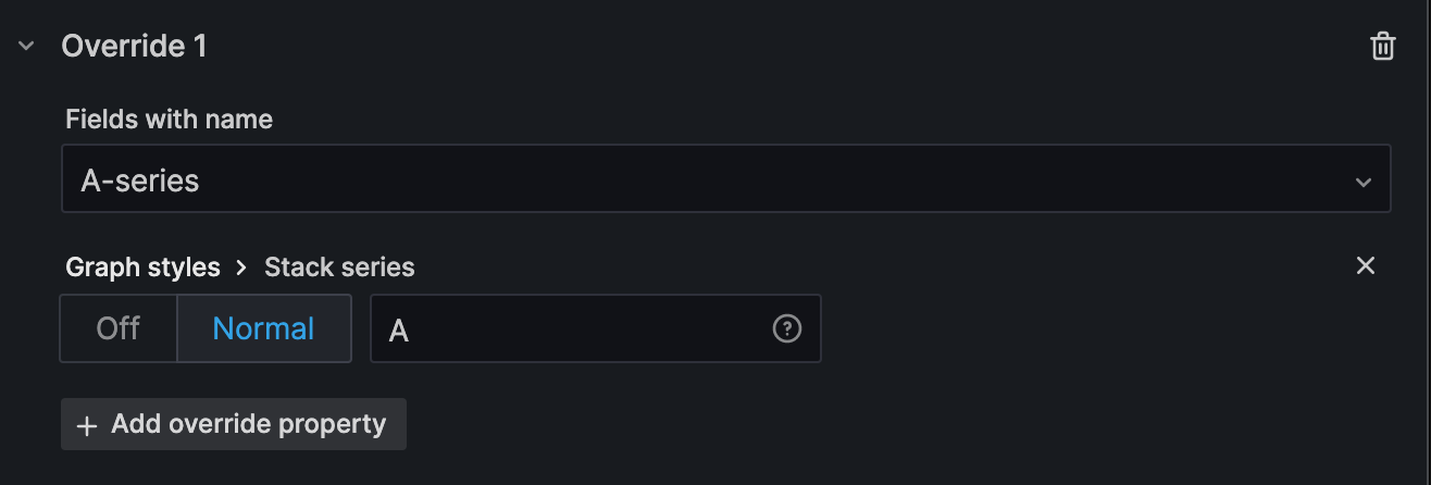

Stack series in the same group. In the Overrides section:
  1. Create a field override for Stack series option.
    Stack series override
  2. Click on Normal stacking mode.
  3. Name the stacking group you want the series to appear in. The stacking group name option is only available when creating an override.
Stack series override editor

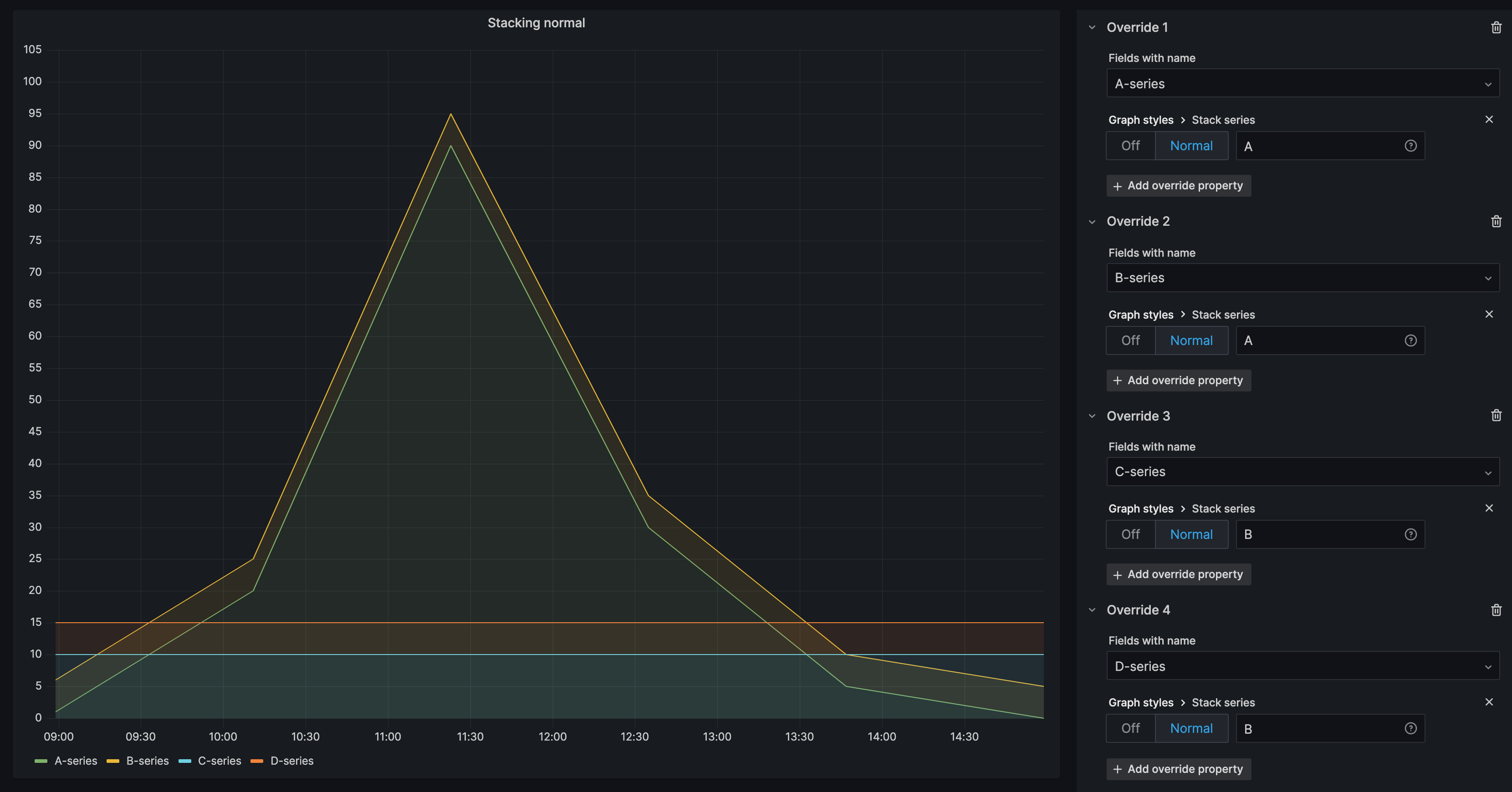

A-series and B-series stacked in group A, C-series, and D-series stacked in group B:
Stacking groups example
