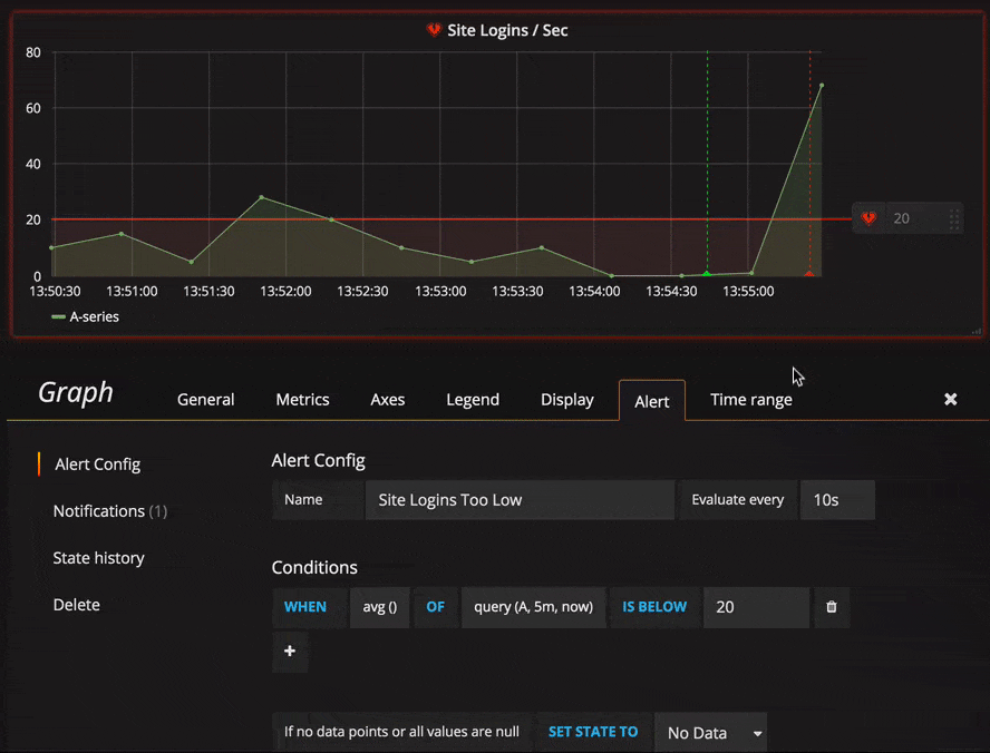

Grafana alerting allows you to attach rules to your dashboard panels. When you save the dashboard, Grafana extracts the alert rules into a separate alert rule storage and schedules them for evaluation.
Alerting overview
In the Alert tab of the graph panel you can configure how often the alert rule should be evaluated and the conditions that need to be met for the alert to change state and trigger its notifications.
Currently only the graph panel supports alert rules.
Add or edit an alert rule
  1. Navigate to the panel you want to add or edit an alert rule for, click the title, and then click Edit.
  2. On the Alert tab, click Create Alert. If an alert already exists for this panel, then you can just edit the fields on the Alert tab.
  3. Fill out the fields. Descriptions are listed below in Alert rule fields.
  4. When you have finished writing your rule, click Save in the upper right corner to save alert rule and the dashboard.
  5. (Optional but recommended) Click Test rule to make sure the rule returns the results you expect.

  • Name - Enter a descriptive name. The name will be displayed in the Alert Rules list. This field supports templating.
  • Evaluate every - Specify how often the scheduler should evaluate the alert rule. This is referred to as the evaluation interval.

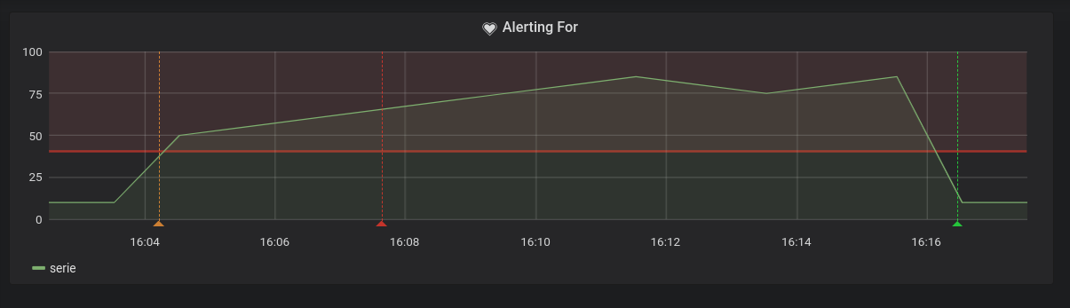

  • For - Specify how long the query needs to violate the configured thresholds before the alert notification triggers.
You can set a minimum evaluation interval in the alerting.min_interval_seconds configuration field, to set a minimum time between evaluations. Refer to Configuration for more information.

If an alert rule has a configured For and the query violates the configured threshold, then it will first go from OK to Pending. Going from OK to Pending Grafana will not send any notifications. Once the alert rule has been firing for more than For duration, it will change to Alerting and send alert notifications.
Typically, it’s always a good idea to use this setting since it’s often worse to get false positive than wait a few minutes before the alert notification triggers. Looking at the Alert list or Alert list panels you will be able to see alerts in pending state.
Below you can see an example timeline of an alert using the For setting. At ~16:04 the alert state changes to Pending and after 4 minutes it changes to Alerting which is when alert notifications are sent. Once the series falls back to normal the alert rule goes back to OK.

Currently the only condition type that exists is a Query condition that allows you to specify a query letter, time range and an aggregation function.
Query condition example
sql
avg() OF query(A, 15m, now) IS BELOW 14
  • avg() Controls how the values for each series should be reduced to a value that can be compared against the threshold. Click on the function to change it to another aggregation function.
  • query(A, 15m, now) The letter defines what query to execute from the Metrics tab. The second two parameters define the time range, 15m, now means 15 minutes ago to now. You can also do 10m, now-2m to define a time range that will be 10 minutes ago to 2 minutes ago. This is useful if you want to ignore the last 2 minutes of data.
  • IS BELOW 14 Defines the type of threshold and the threshold value. You can click on IS BELOW to change the type of threshold.
