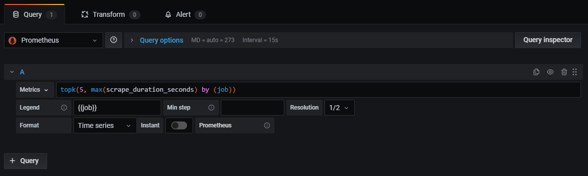

Query editors
Query editors are forms that help you write queries. Depending on your data source, the query editor might provide auto-completion, metric names, or variable suggestion.
Because of the difference between query languages, data sources may have query editors that look different. Here are two examples of query editors:
InfluxDB query editor
Prometheus (PromQL) query editor

Query tab UI
The Query tab consists of the following elements:
  • Data source selector
  • Query options
  • Query inspector button
  • Query editor list

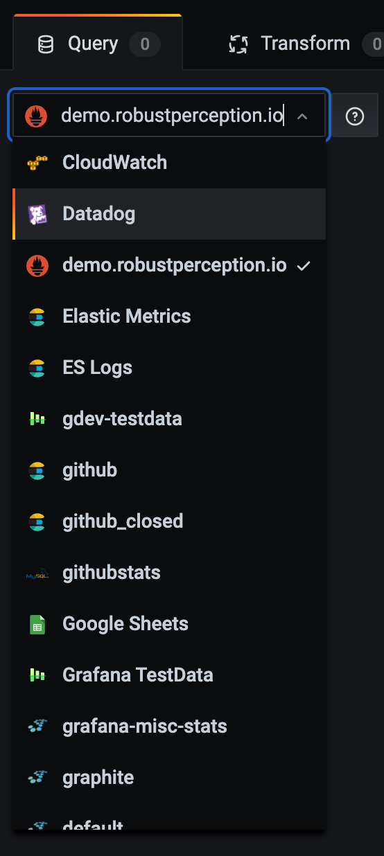

The data source selector is a drop-down list. Click it to select a data source you have added. When you create a panel, Grafana automatically selects your default data source. For more information about adding data sources, refer to Add a data source.
In addition to the data sources that you have configured in your Grafana, there are three special data sources available:
  • Grafana - A built-in data source that generates random walk data. Useful for testing visualizations and running experiments.
  • Mixed - Select this to query multiple data sources in the same panel. When this data source is selected, Grafana allows you to select a data source for every new query that you add.
    • The first query will use the data source that was selected before you selected Mixed.
    • You cannot change an existing query to use the Mixed Data Source.
  • Dashboard - Select this to use a result set from another panel in the same dashboard.

Query editor list
In the UI, queries are organized in collapsible query rows. Each query row contains a query editor and is identified with a letter (A, B, C, and so on).
You can:
IconDescription
Copy a query. Duplicating queries is useful when working with multiple complex queries that are similar and you want to either experiment with different variants or do minor alterations.
Hide a query. Grafana does not send hidden queries to the data source.
Remove a query. Removing a query permanently deletes it, but sometimes you can recover deleted queries by reverting to previously saved versions of the panel.
Reorder queries. Change the order of queries by clicking and holding the drag icon, then drag queries where desired. The order of results reflects the order of the queries, so you can often adjust your visual results based on query order.
