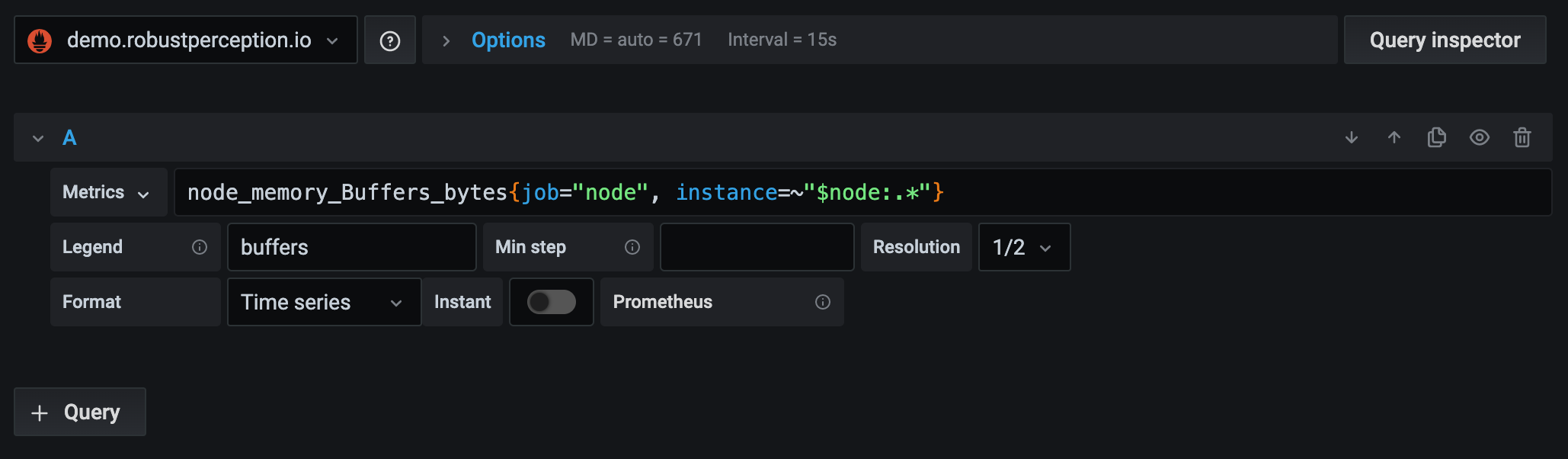

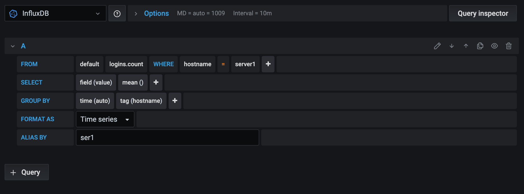

Because of the difference between query languages, data sources may have query editors that look different. Here are two examples of query editors:
InfluxDB query editor
Prometheus (PromQL) query editor
