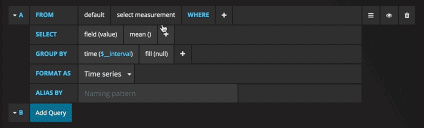

Query Editor
You can access the InfluxDB editor under the metrics tab when you are in the edit mode of the Graph or Singlestat panels. Enter edit mode by clicking the panel title, and clicking Edit. The editor allows you to select metrics and tags.
Filter data (WHERE)
To add a tag filter click the plus icon to the right of the WHERE condition. You can remove tag filters by clicking on
the tag key and then selecting --remove tag filter--.
Regex matching
You can type in regex patterns for metric names or tag filter values. Be sure to wrap the regex pattern in forward slashes (/). Grafana automatically adjusts the filter tag condition to use the InfluxDB regex match condition operator (=~).
Field and Aggregation functions
In the SELECT row you can specify what fields and functions you want to use. If you have a
group by time you need an aggregation function. Some functions like derivative require an aggregation function. The editor tries to simplify and unify this part of the query. For example:
The above generates the following InfluxDB SELECT clause:
SELECT derivative(mean("value"), 10s) /10 AS "REQ/s" FROM ....Select multiple fields
Use the plus button and select Field > field to add another SELECT clause. You can also
specify an asterix * to select all fields.

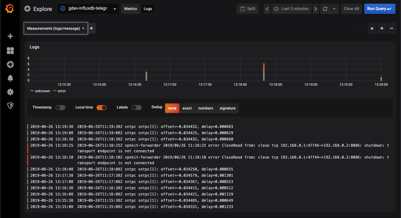

Querying Logs (BETA)
Only available in Grafana v6.3+.
Querying and displaying log data from InfluxDB is available via Explore.
Select the InfluxDB data source, change to Logs using the Metrics/Logs switcher,
and then use the Measurements/Fields button to display your logs.
Log Queries
The Logs Explorer (the Measurements/Fields button) next to the query field shows a list of measurements and fields. Choose the desired measurement that contains your log data and then choose which field Explore should use to display the log message.
Once the result is returned, the log panel shows a list of log rows and a bar chart where the x-axis shows the time and the y-axis shows the frequency/count.
Filter search
To add a filter click the plus icon to the right of the Measurements/Fields button or a condition. You can remove tag filters by clicking on the first select and choosing --remove filter--.
