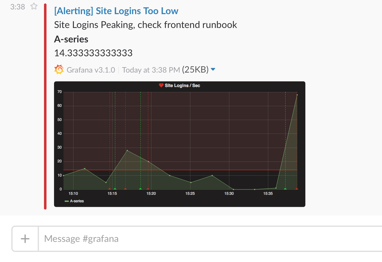

Slack
To set up Slack, you need to configure an incoming Slack webhook URL. You can follow Sending messages using Incoming Webhooks on how to do that. If you want to include screenshots of the firing alerts in the Slack messages you have to configure either the external image destination in Grafana or a bot integration via Slack Apps. Follow Slack’s guide to set up a bot integration and use the token provided, which starts with “xoxb”.
If you are using the token for a slack bot, then you have to invite the bot to the channel you want to send notifications and add the channel to the recipient field.

Enable images in notifications
Grafana can render the panel associated with the alert rule as a PNG image and include that in the notification. Read more about the requirements and how to configure image rendering.
You must configure an external image storage provider in order to receive images in alert notifications. If your notification channel requires that the image be publicly accessible (e.g. Slack, PagerDuty), configure a provider which uploads the image to a remote image store like Amazon S3, Webdav, Google Cloud Storage, or Azure Blob Storage. Otherwise, the local provider can be used to serve the image directly from Grafana.
Notification services which need public image access are marked as ’external only'.
