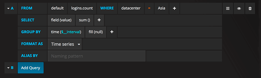

Query Editor
You find the InfluxDB editor in the metrics tab in Graph or Singlestat panel’s edit mode. You enter edit mode by clicking the panel title, then edit. The editor allows you to select metrics and tags.
Filter data (WHERE)
To add a tag filter click the plus icon to the right of the WHERE condition. You can remove tag filters by clicking on the tag key and select --remove tag filter--.

Field & Aggregation functions
In the SELECT row you can specify what fields and functions you want to use. If you have a group by time you need an aggregation function. Some functions like derivative require an aggregation function. The editor tries simplify and unify this part of the query. For example:
The above will generate the following InfluxDB SELECT clause:
SQL
SELECT derivative(mean("value"), 10s) /10 AS "REQ/s" FROM ....
