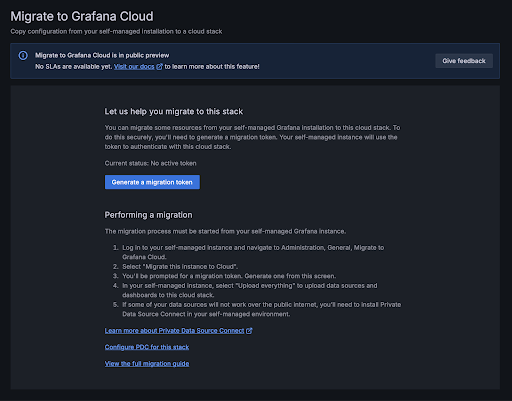

Generate a migration token on the destination cloud instance:
  1. Navigate to Home > Administration > General > Migrate to Grafana Cloud in the cloud instance where you intend to migrate your resources.
  2. Click on the Generate a migration token button.
    The Generate a migration token button in the Migrate to Grafana Cloud page in the intended Grafana Cloud Stack
  3. Make a copy of the migration token by copying to clipboard. The token is required to authenticate your self-managed instance with the Grafana Cloud Stack.

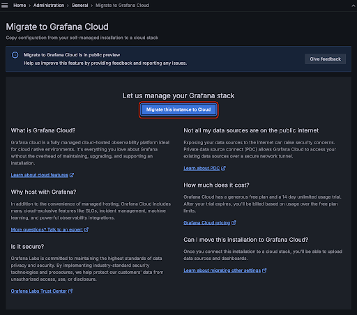

  1. On your self-managed Grafana instance, navigate to Home > Administration > General > Migrate to Grafana Cloud.
  2. Click the Migrate this instance to Cloud button.
    The Migrate this instance to Cloud button in the Migrate to Grafana Cloud page on a self-managed Grafana instance

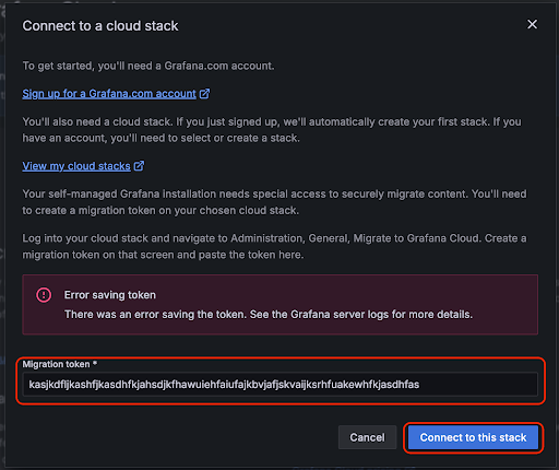

  3. Enter your token and click Connect to this Stack.
    The Migration token field and Connect to this stack button in the Connect to a cloud stack page in a self-managed Grafana instance

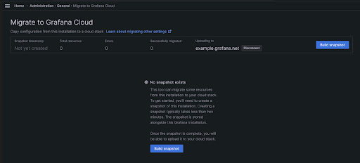

Build a snapshot
After connecting to the cloud stack, this is the empty state of the migration assistant. You need to create a snapshot of the self-managed Grafana instance to upload it to the cloud stack.
  • Click Build snapshot
    The Build snapshot button on the Migrate to Grafana Cloud page in a self-managed Grafana instance

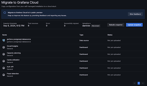

Upload resources to the cloud
After a snapshot is created, a list of resources appears with resource Type and Status populated with Not yet uploaded.
A list of resources with snapshots built but not yet uploaded to Grafana Cloud

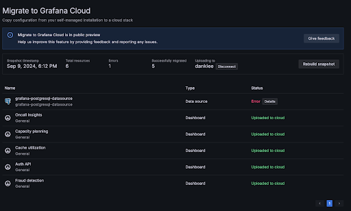

  1. Click on Upload snapshot to copy the resources to the Grafana Cloud instance. This also updates statuses for the list of resources. The status changes to ‘Uploaded to cloud’ for resources successfully copied to the cloud.
    The Snapshot information also updates to inform the user of total resources, errors, and total number of successfully migrated resources.
    An updates list of resources with snapshots built after attempting to upload them to Grafana Cloud
  2. Use the assistant’s real-time progress tracking to monitor the migration.
  3. Review error details for any issues that need manual resolution.
