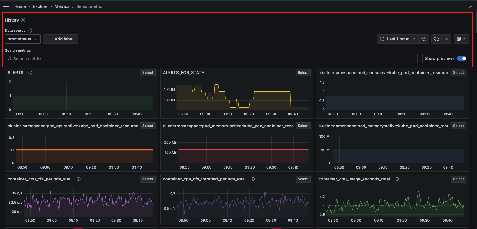

Standalone experience
To access Explore Metrics as a standalone experience:
  1. Click the arrow next to Explore in the Grafana left-side menu and click Metrics. You are taken to an overview page that shows recent metrics, bookmarks, and the option to select a new metric exploration.
  2. To get started with a new exploration, click + New metric exploration.
  3. Select Prometheus or any Prometheus-compatible data source available in the drop-down menu under Data source.
  4. Click + Add label to select a label-value pair from the drop-down menu. You can add multiple label-value pairs. A label type will appear above the selected label with a drop-down list of options from which to choose. For example, if you select the label container a drop-down list of available containers appears.
  5. You can also search for metrics using keywords under Search metrics in the search bar.
  6. Use the time picker to select a date and time range from the drop-down menu or use an absolute time range.
  7. Click the down arrow next to the Refresh icon to set a refresh rate from the drop-down menu. The default is Off.
  8. Click the Settings icon and toggle Always keep selected metric graph in-view to keep your main graph always in view on the Breakdown drill-down tab.
The History button in the upper left corner tracks every step navigating through metric exploration.
show metrics explore overview

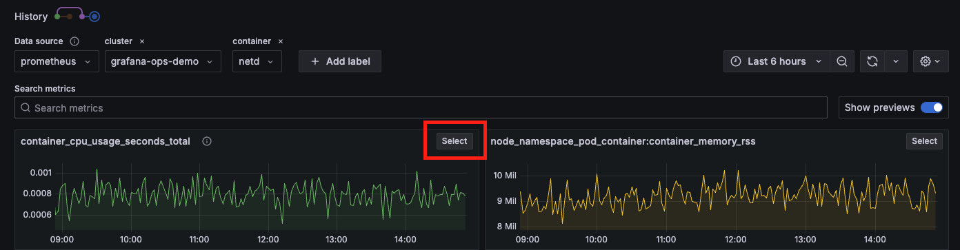

Metrics exploration
To further explore a metric, click Select in the upper right corner of the metric visualization.
show select box
  • The Overview tab provides a description for each metric, as well as the metric type and unit associated with the metric. It also provides a list of labels associated with the metric. Click on any label to view drill-down visualizations.
  • The Breakdown tab depicts time series visualizations for each of the label-value pairs for the selected metric. You can further drill down on each label and click Add to filter to add the label/value pair into your filters. You can also change the View from grid to rows.
  • The Related metrics tab depicts related metrics with relevant key words. You can repeat the drill down process for any related metric. Toggle SHow previews to preview visualizations.
