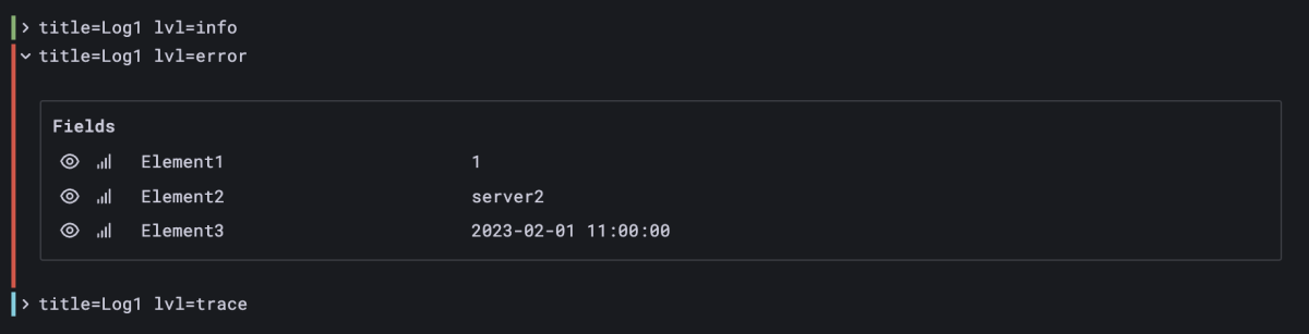

Example
TimeTitleMessageElement1Element2Element3
2023-02-01 12:00:00title=Log1 lvl=info1server22023-02-01 11:00:00
2023-02-01 11:30:00title=Log1 lvl=error1server22023-02-01 11:00:00
2023-02-01 11:00:00title=Log1 lvl=trace1server22023-02-01 11:00:00
Logs Example
