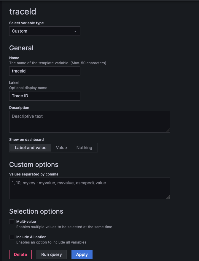

Go to the dashboard Settings and add a new variable called
traceId
, of variable type Custom, giving it a label if required. Select Apply to add the variable to the dashboard.Add a Custom variable Verify that the panel works by using a valid trace ID for the data source used for the trace panel and editing the ID in the dashboard variable.
