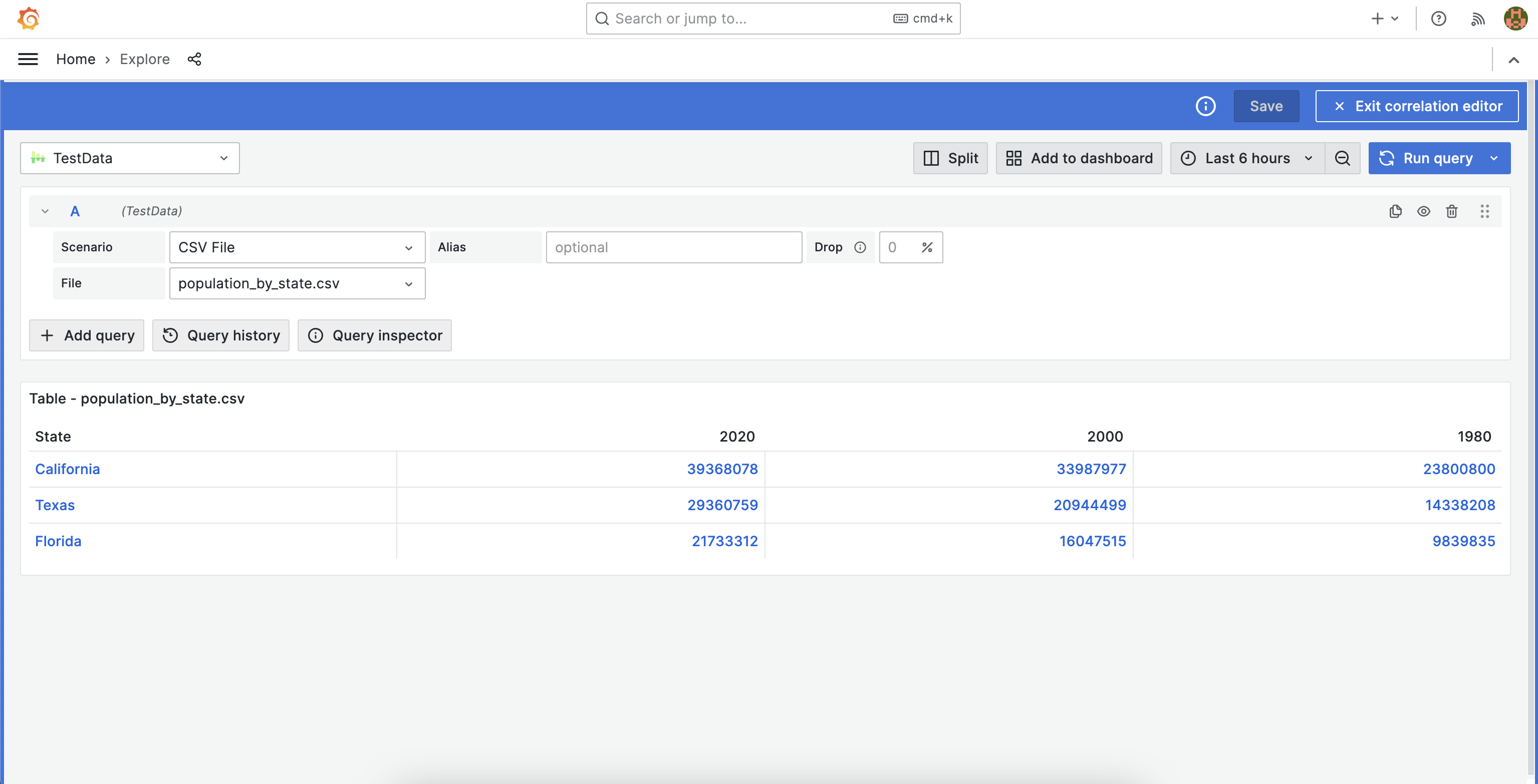

  4. Explore is now in Correlations Editor mode, indicated by a blue border.
  5. Select the following scenario from the scenario dropdown menu: CSV File.
  6. Select the file, population_by_state.csv. Each cell is a link that you can click on to begin creating a new correlation.
    Selecting the source of a correlation
  7. Click on any cell in the State column to create a new correlation that attaches a data link to that entry. For example, select “California”.

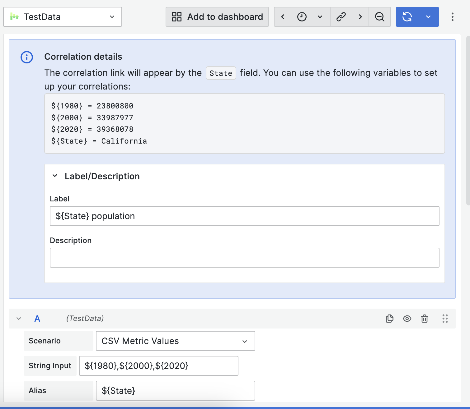

  8. In the split view, select the same data source you selected in the left pane. The helper above the query editor contains all available variables you can use the target query. Variables contain all data fields (table columns) from the selected row.
  9. In the Scenario menu, select CSV Metric Values. The String Input field in the Query editor provides variables with population values for each year: ${1980},${2000},${2020}. This will generate a graph using variable values.
  10. In the Query Editor Alias field, enter “${State}”.
    Setting up the target of a correlation
    Run a query to see that it produces a graph using sample values from the variables.

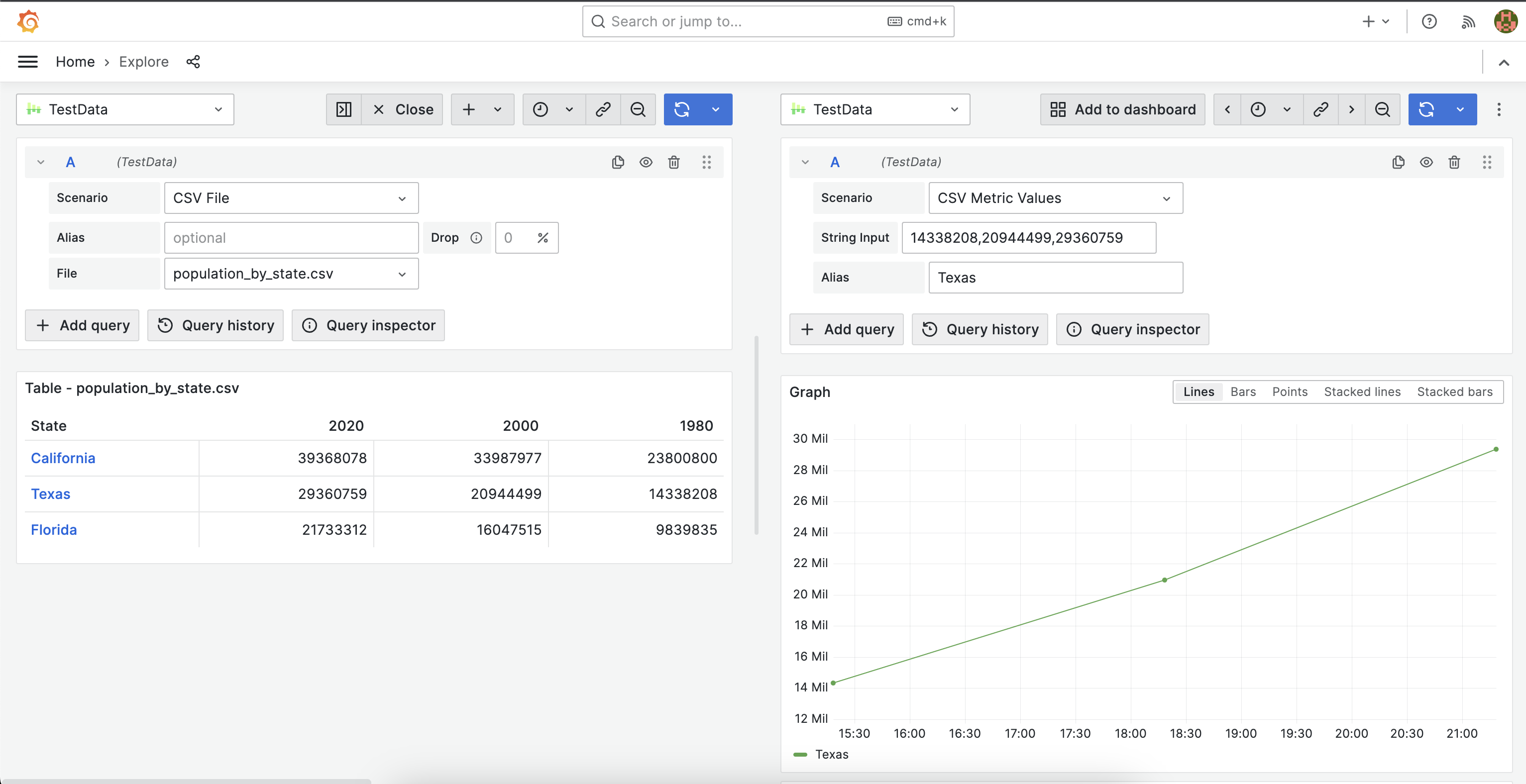

  11. Click Save to save the correlation and exit the Correlations Editor.
    After the correlation is saved, Explore will rerun the query in the left pane. By clicking a state name, the query on the right is rerun with values from the row being inserted into the CSV, thus changing the graph. The query is rerun with updated values every time you click on a state name.
    Result of clicking on a data link
You can apply the same steps to any data source. Correlations allow you to create links in visualizations to run dynamic queries based on selected data. In this example we used data returned by a query to build a new query generating different visualization using the same data source. However, you can create correlations between any data sources to create custom exploration flows.
