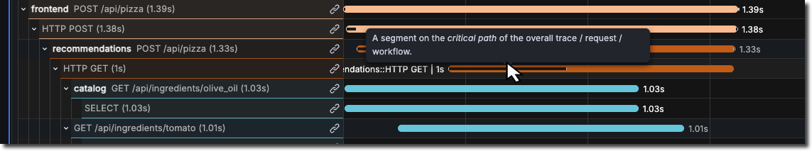

Timeline shows list of spans within the trace. Each span row consists of the following components:
- Expand children - Expands or collapses all the children spans of the selected span.
 - Service name - Name of the service logged the span.
 - Operation name - Name of the operation that this span represents.
 - Span duration bar - Visual representation of the operation duration within the trace.
Click anywhere on the span row to reveal span details.
The Span duration bar highlights the trace’s critical path with a darker segment. This darker segment means the span lies on the trace’s critical path, following the CRISP (Critical Path for Service Performance) algorithm.
Use the highlight to focus on spans that drive end‑to‑end latency. Spans outside the critical path do not increase the trace duration.
You can also focus on this path by clicking the Show critical path only button in the Span filters options.
