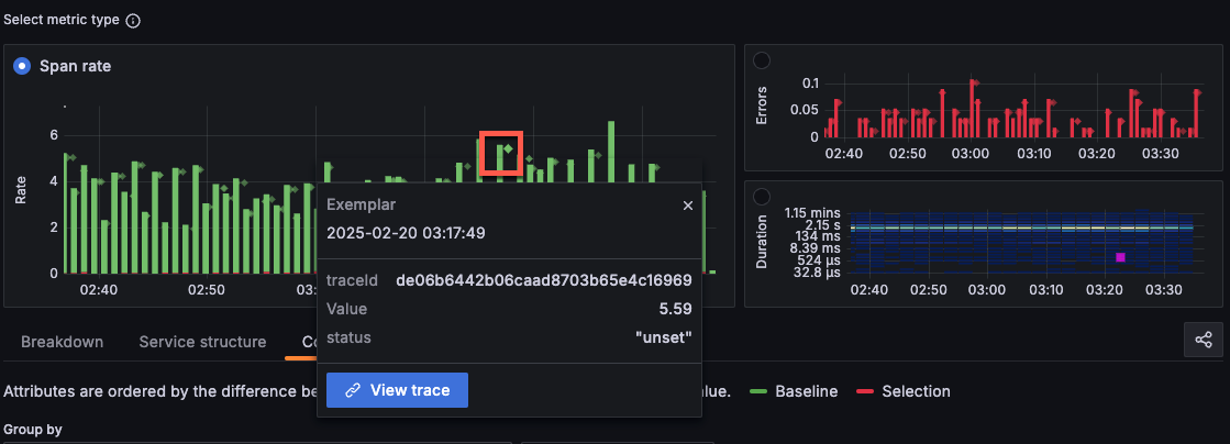

In Traces Drilldown, exemplar data is represented by a small diamond next to the bar graphs. You can view the exemplar information by hovering the cursor over the small diamond.
A small diamond next to the bar graph indicates that exemplar data is available.

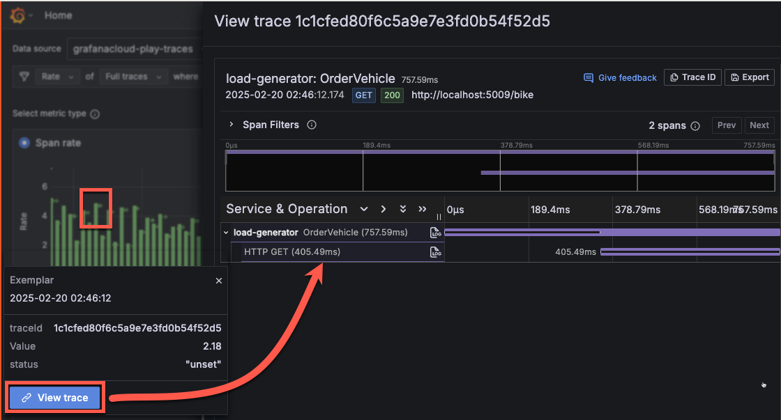

Select View trace to open a slide-out trace panel.
Selecting View trace reveals a slide-out panel with the full trace information.
