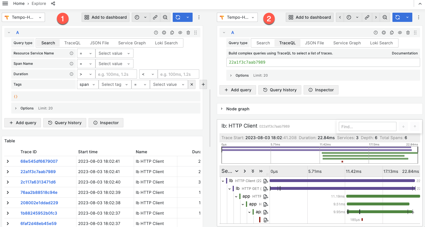

In the screenshot below, the left side of the screen (1) shows the list of results for the query. The right side (2) lists each span that makes up the selected trace.
Traces example with query results and spans
