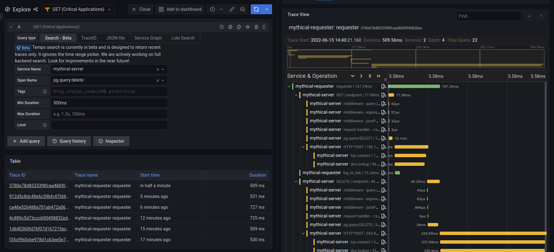

Search for traces
Search for traces using common dimensions such as time range, duration, span tags, service names, etc. Use the Explore trace view to quickly diagnose errors and high latency events in your system.

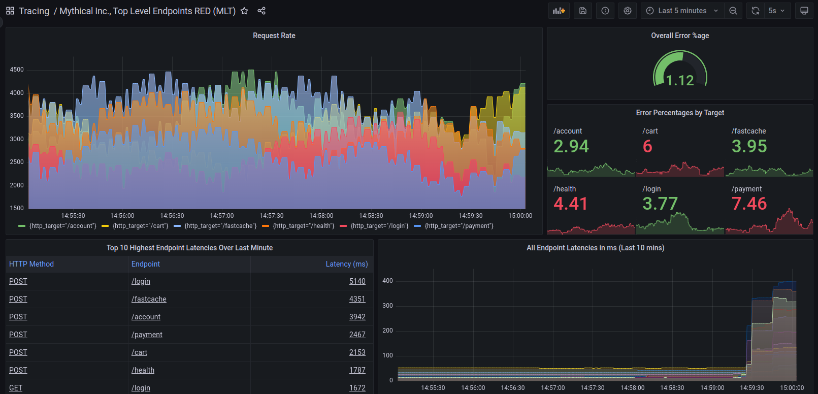

RED metrics can drive service graphs and other ready-to-go visualizations of your span data. RED metrics represent:
  • Rate, the number of requests per second
  • Errors, the number of those requests that are failing
  • Duration, the amount of time those requests take
For more information about RED method, refer to The RED Method: how to instrument your services.

These metrics exist in your Hosted Metrics instance and can also be easily used to generate powerful custom dashboards.
Custom Metrics Dashboard

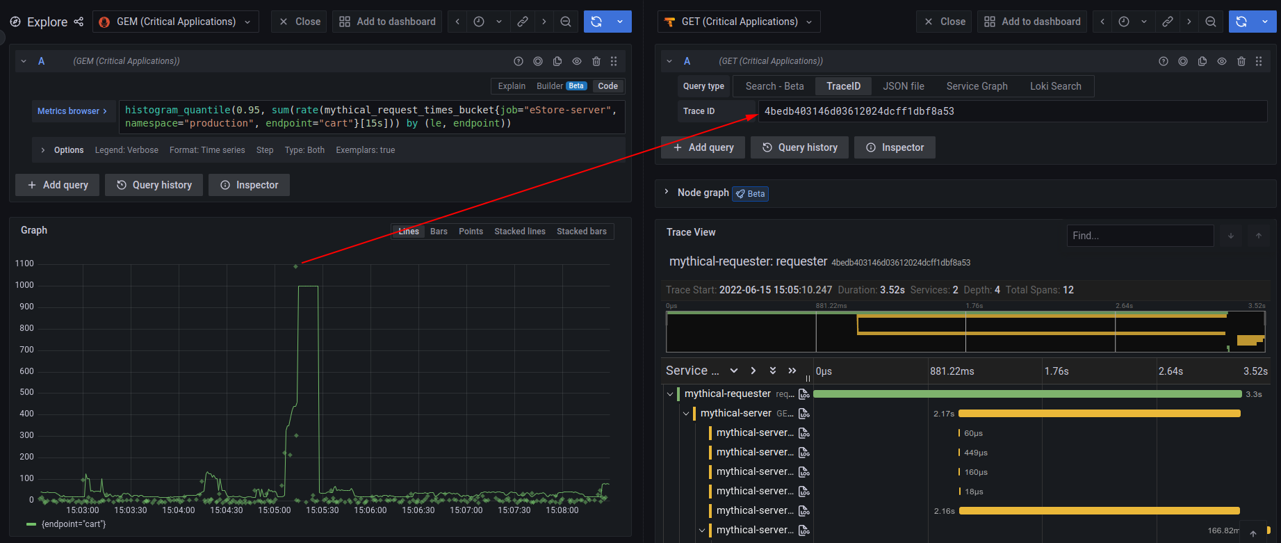

Metrics automatically generate exemplars as well which allows easy metrics to trace linking.
Trace Exemplars

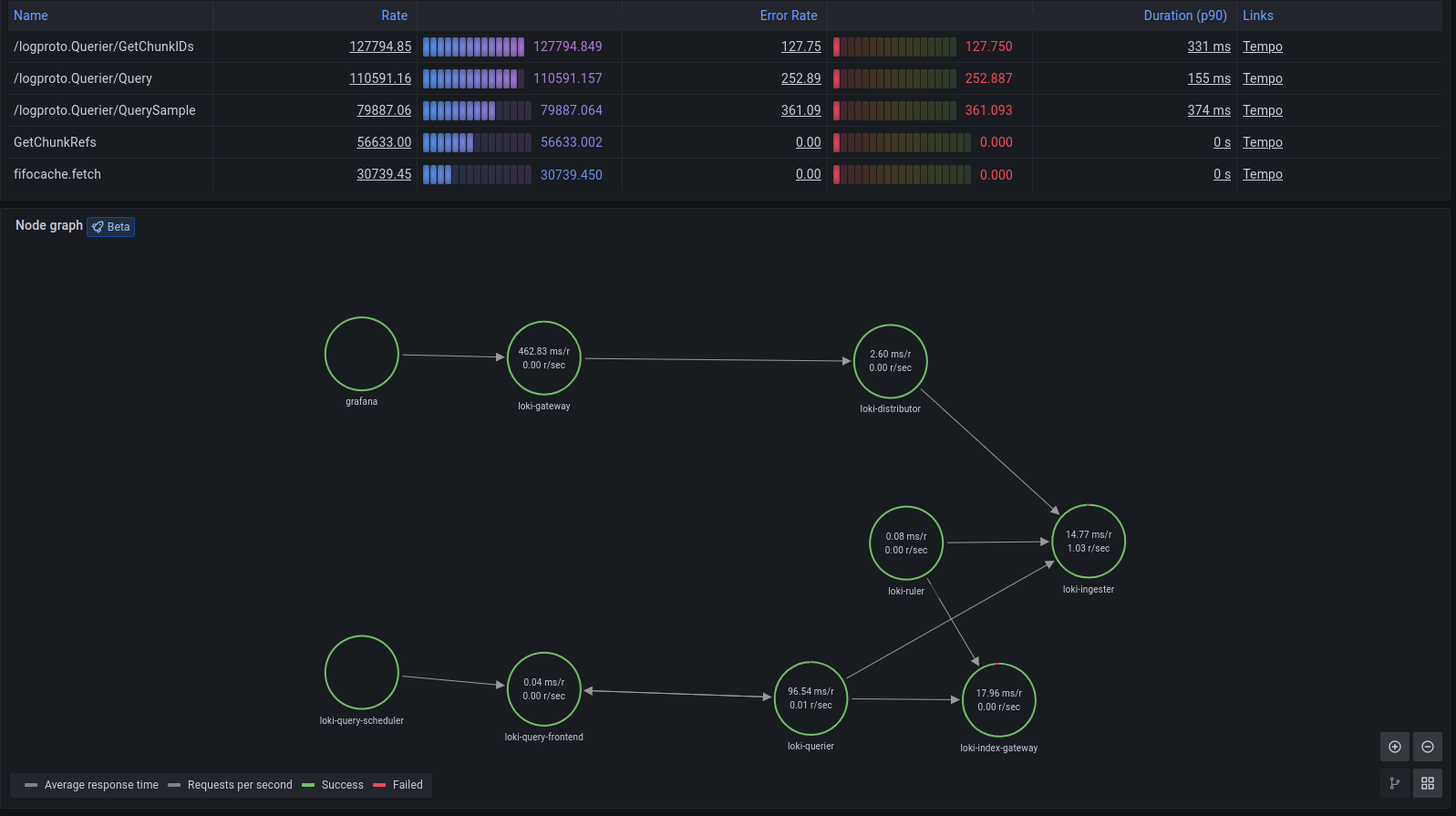

Service graph view displays a table of request rate, error rate, and duration metrics (RED) calculated from your incoming spans. It also includes a node graph view built from your spans.
To use the service graph view, you need to enable service graphs and span metrics. After it’s enabled, this pre-configured view is immediately available in Explore > Service Graphs.
Refer to the service graph view documentation for further information.
Service graph view overview

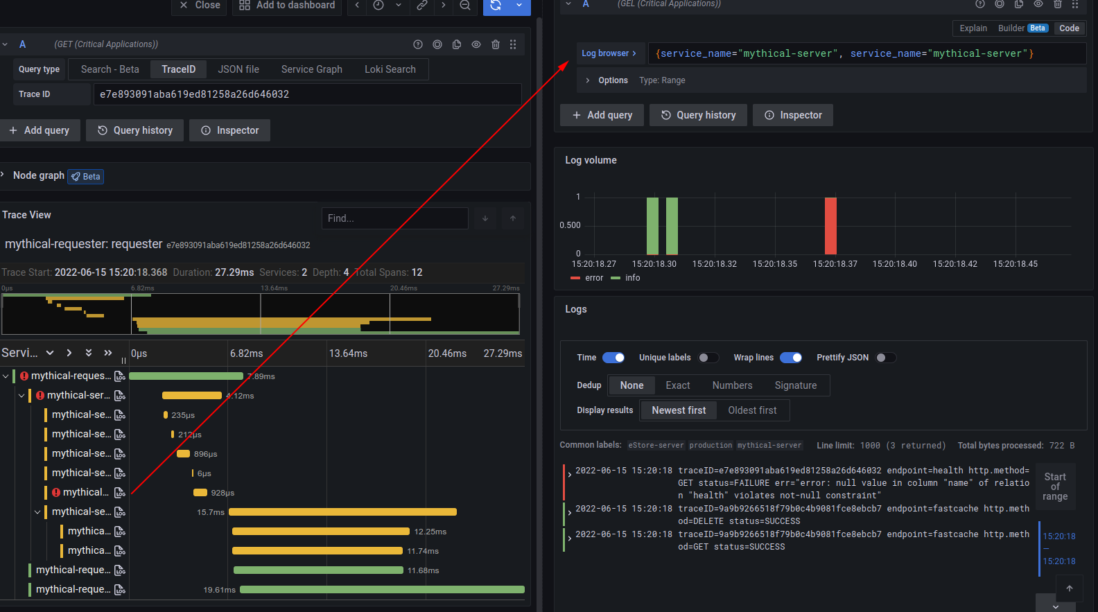

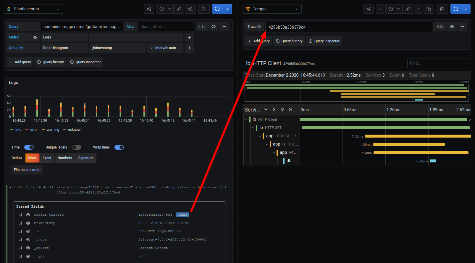

If you’re already doing request/response logging with trace IDs, they can be easily extracted from logs to jump directly to your traces.
Logs to Traces visualization
In the other direction, you can configure Grafana and Grafana Cloud to create a link from an individual span to your Loki logs. If you see a long-running span or a span with errors, you can immediately jump to the logs of the process causing the error.
Traces to Logs visualization

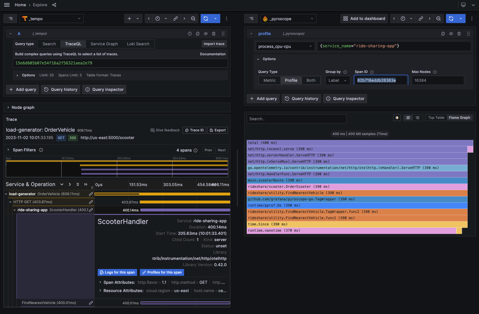

Using Trace to profiles, you can correlate different signals by adding the functionality to link between traces and profiles.
Trace to profiles lets you link your Grafana Pyroscope data source to tracing data in Grafana or Grafana Cloud. When configured, this connection lets you run queries from a trace span into the profile data.
Selecting a link in the span queries the profile data source
For more information, refer to the Traces to profiles documentation and the Grafana Pyroscope data source documentation.
