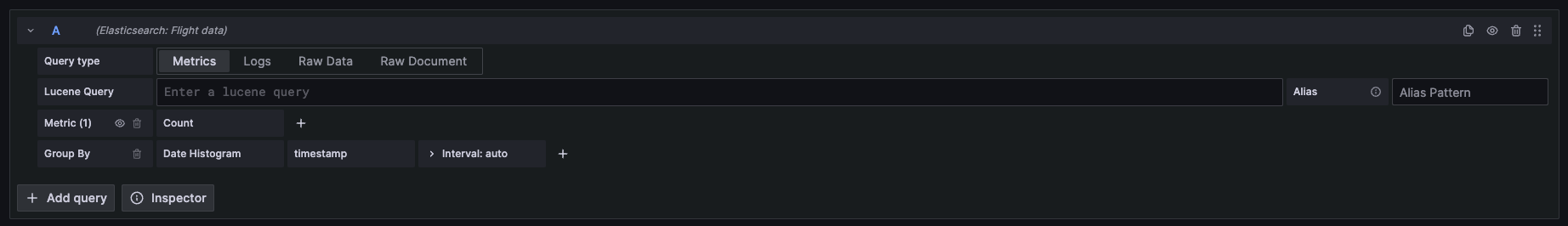

Select a query type
There are three types of queries you can create with the Elasticsearch query builder. Each type is explained in detail below.
Metrics query type
Metrics queries aggregate data and produce calculations such as count, min, max, and more. Click the metric box to view options in the drop-down menu. The default is count.
Alias - Aliasing only applies to time series queries, where the last group is
date histogram. This is ignored for any other type of query.Metric - Metrics aggregations include:

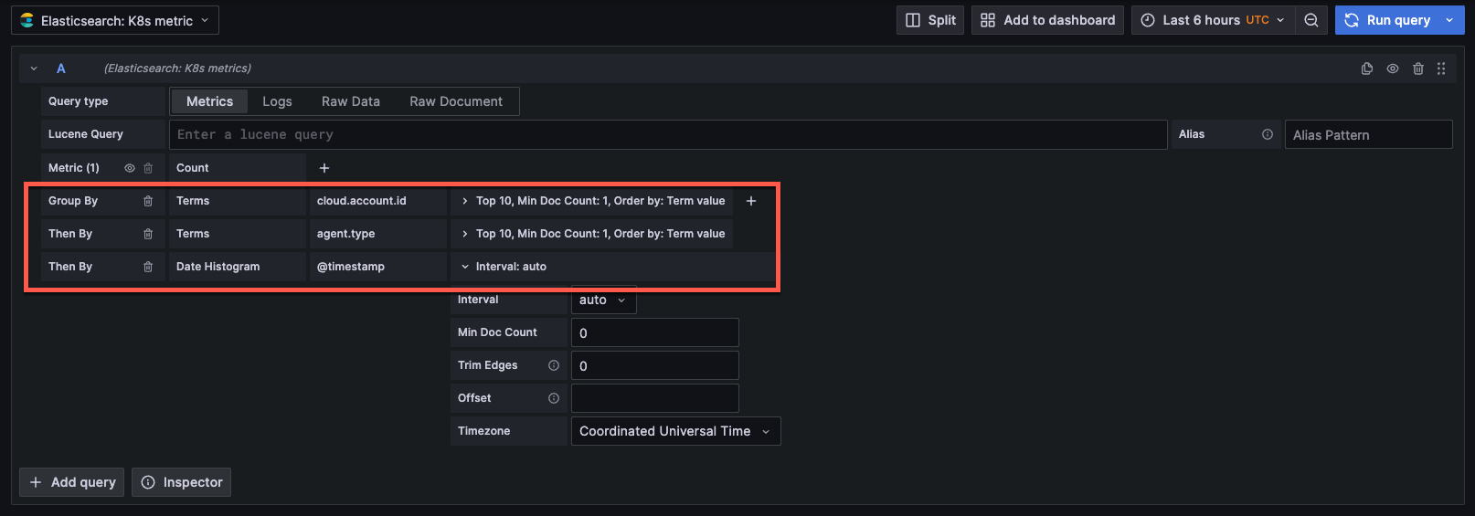

You can select multiple metrics and group by multiple terms or filters when using the Elasticsearch query editor.
Use the + sign to the right to add multiple metrics to your query. Click on the eye icon next to Metric to hide metrics, and the garbage can icon to remove metrics.
- Group by options - Create multiple group by options when constructing your Elasticsearch query. Date histogram is the default option. The following options are available in the drop-down menu:
- terms - refer to Terms aggregation.
- filter - refer to Filter aggregation.
- geo hash grid - refer to Geohash grid aggregation.
- date histogram - for time series queries. Refer to Date histogram aggregation.
- histogram - Depicts frequency distributions. Refer to Histogram aggregation.
- nested (experimental) - Refer to Nested aggregation.
Each group by option will have a different subset of options to further narrow your query.
