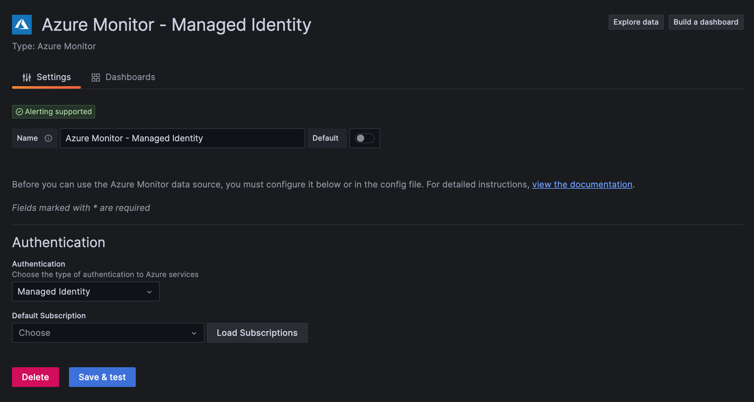

Configure Managed Identity
Note
Managed Identity is available only in Azure Managed Grafana or Grafana OSS/Enterprise when deployed in Azure. It is not available in Grafana Cloud.
You can use managed identity to configure Azure Monitor in Grafana if you host Grafana in Azure (such as an App Service or with Azure Virtual Machines) and have managed identity enabled on your VM. This lets you securely authenticate data sources without manually configuring credentials via Azure AD App Registrations. For details on Azure managed identities, refer to the Azure documentation.
To enable managed identity for Grafana:
  1. Set the managed_identity_enabled flag in the [azure] section of the Grafana server configuration.
    ini
    [azure]
    managed_identity_enabled = true
  2. In the Azure Monitor data source configuration, set Authentication to Managed Identity.
    This hides the directory ID, application ID, and client secret fields, and the data source uses managed identity to authenticate to Azure Monitor Metrics and Logs, and Azure Resource Graph.
    Azure Monitor screenshot showing Managed Identity authentication

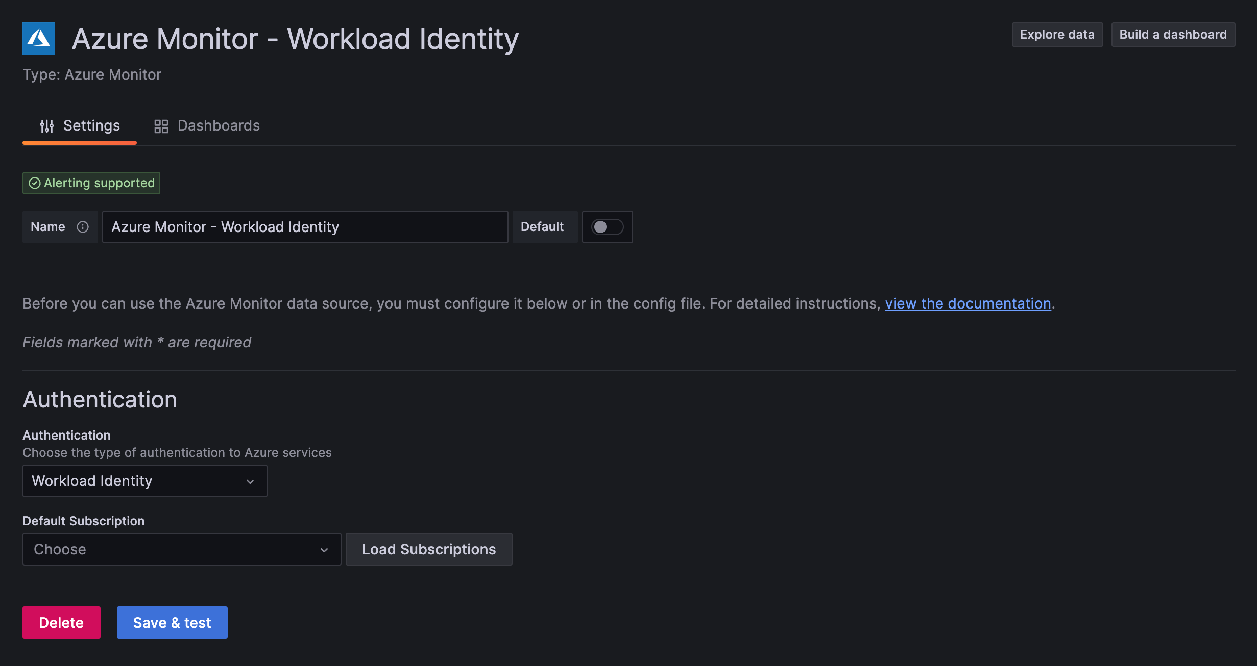

Configure Workload Identity
You can use workload identity to configure Azure Monitor in Grafana if you host Grafana in a Kubernetes environment, such as AKS, in conjunction with managed identities. This lets you securely authenticate data sources without manually configuring credentials via Azure AD App Registrations. For details on workload identity, refer to the Azure workload identity documentation.
To enable workload identity for Grafana:
  1. Set the workload_identity_enabled flag in the [azure] section of the Grafana server configuration.
    ini
    [azure]
    workload_identity_enabled = true
  2. In the Azure Monitor data source configuration, set Authentication to Workload Identity.
    This hides the directory ID, application ID, and client secret fields, and the data source uses workload identity to authenticate to Azure Monitor Metrics and Logs, and Azure Resource Graph.
    Azure Monitor screenshot showing Workload Identity authentication

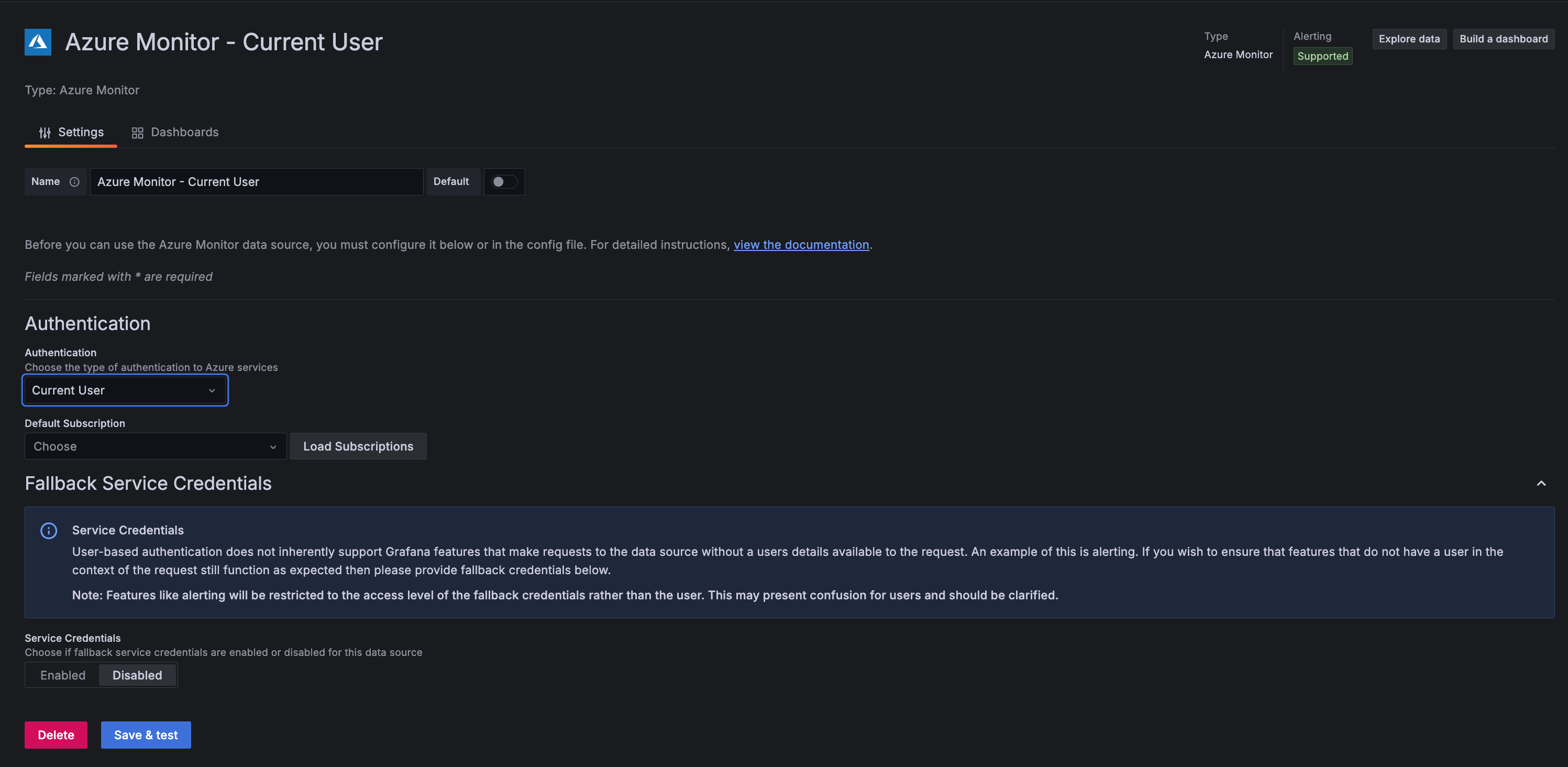

Configure Current User authentication
Note
Current user authentication is an experimental feature. Engineering and on-call support is not available. Documentation is either limited or not provided outside of code comments. No SLA is provided. Contact Grafana Support to enable this feature in Grafana Cloud. Aspects of Grafana may not work as expected when using this authentication method.
If your Grafana instance is configured with Azure Entra (formerly Active Directory) authentication for login, this authentication method can be used to forward the currently logged in user’s credentials to the data source. The users credentials will then be used when requesting data from the data source. For details on how to configure your Grafana instance using Azure Entra refer to the documentation.
Note
Additional configuration is required to ensure that the App Registration used to login a user via Azure provides an access token with the permissions required by the data source.
The App Registration must be configured to issue both Access Tokens and ID Tokens.
  1. In the Azure Portal, open the App Registration that requires configuration.
  2. Select Authentication in the side menu.
  3. Under Implicit grant and hybrid flows check both the Access tokens and ID tokens boxes.
  4. Save the changes to ensure the App Registration is updated.
The App Registration must also be configured with additional API Permissions to provide authenticated users with access to the APIs utilised by the data source.
  2. Select API Permissions in the side menu.
  3. Ensure the openid, profile, email, and offline_access permissions are present under the Microsoft Graph section. If not, they must be added.
  4. Select Add a permission and choose the following permissions. They must be added individually. Refer to the Azure documentation for more information.
    • Select Azure Service Management > Delegated permissions > user_impersonation > Add permissions
    • Select APIs my organization uses > Search for Log Analytics API and select it > Delegated permissions > Date.Read > Add permissions
Once all permissions have been added, the Azure authentication section in Grafana must be updated. The scopes section must be updated to include the .default scope to ensure that a token with access to all APIs declared on the App Registration is requested by Grafana. Once updated the scopes value should equal: .default openid email profile.
This method of authentication doesn’t inherently support all backend functionality as a user’s credentials won’t be in scope. Affected functionality includes alerting, reporting, and recorded queries. In order to support backend queries when using a data source configured with current user authentication, you can configure service credentials. Also, note that query and resource caching is disabled by default for data sources using current user authentication.
Note
To configure fallback service credentials the feature toggle idForwarding must be set to true and user_identity_fallback_credentials_enabled must be enabled in the Azure configuration section (enabled by default when user_identity_enabled is set to true).
Permissions for fallback credentials may need to be broad to appropriately support backend functionality. For example, an alerting query created by a user is dependent on their permissions. If a user tries to create an alert for a resource that the fallback credentials can’t access, the alert will fail.
To enable current user authentication for Grafana:
  1. Set the user_identity_enabled flag in the [azure] section of the Grafana server configuration. By default this will also enable fallback service credentials. If you want to disable service credentials at the instance level set user_identity_fallback_credentials_enabled to false.
    ini
    [azure]
    user_identity_enabled = true
  2. In the Azure Monitor data source configuration, set Authentication to Current User. If fallback service credentials are enabled at the instance level, an additional configuration section is visible that you can use to enable or disable using service credentials for this data source.
    Azure Monitor screenshot showing Current User authentication
  3. If you want backend functionality to work with this data source, enable service credentials and configure the data source using the most applicable credentials for your circumstances.
