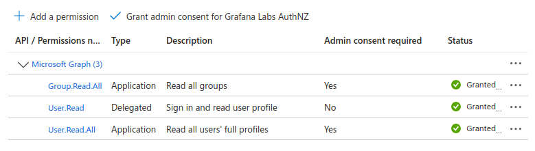

- In the overview pane, look for API permissions section and select Add a permission.
- In the Request API permissions pane, select Microsoft Graph, and click Application permissions.
- In the Select permissions pane, under the GroupMember section, select GroupMember.Read.All.
- In the Select permissions pane, under the User section, select User.Read.All.
- Click the Add permissions button at the bottom of the page.
- In the Request API permissions pane, select Microsoft Graph, and click Delegated permissions.
- In the API permissions section, select Grant admin consent for
The following table shows what the permissions look like from the Azure AD portal:
