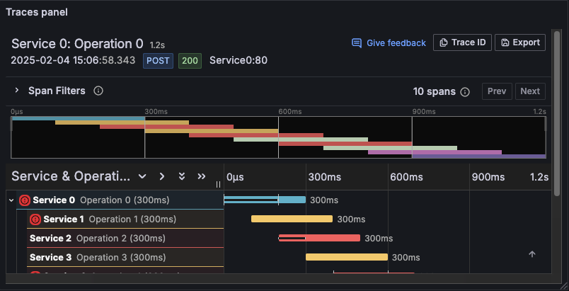

Traces
Traces visualizations let you follow a request as it traverses the services in your infrastructure. The traces visualization displays traces data in a diagram that allows you to easily interpret it. Traces visualizations currently render one trace traversal based on the traceID used in TraceQL or using a variable.

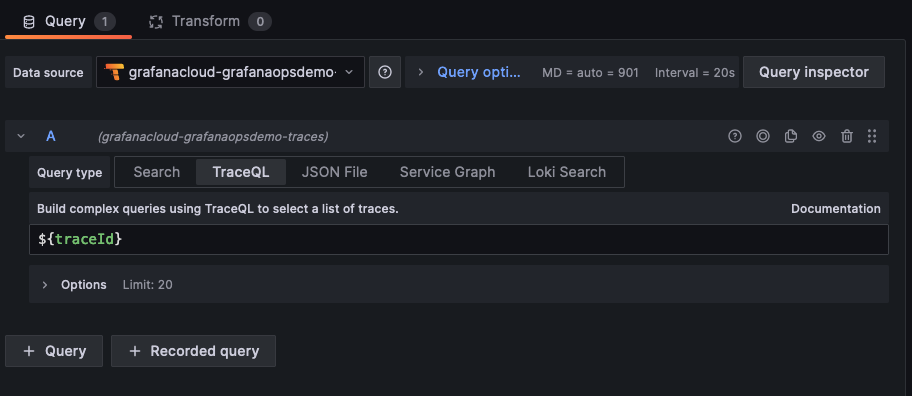

In the query editor, click the TraceQL query type tab.
Enter
${traceId}
in the TraceQL query field to create a dashboard variable. This variable is used as the template query.Click Back to dashboard.

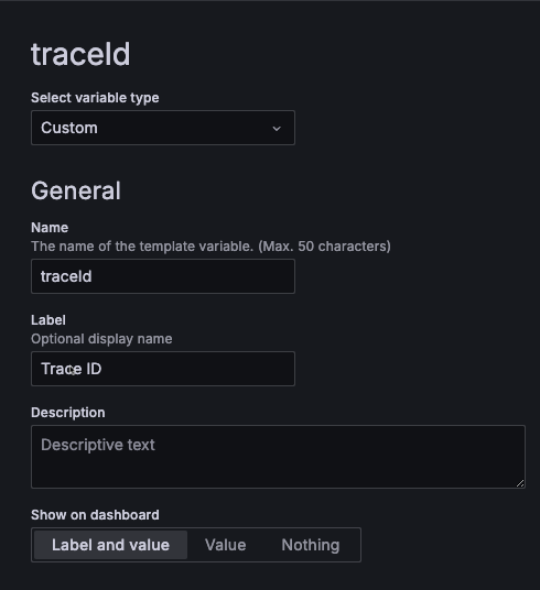

Click Settings and go to the Variables tab.
Add a new variable called
traceId
, of variable type Custom, giving it a label if required.Click Save dashboard.

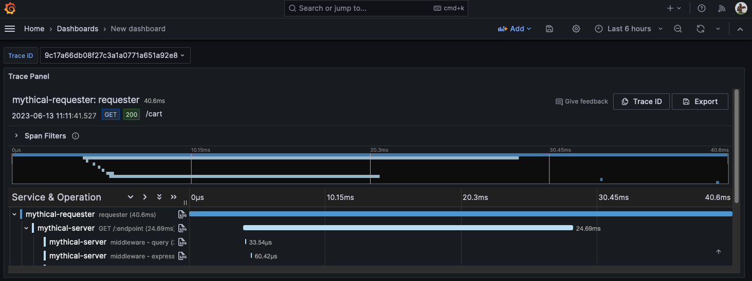

Verify that the panel works by using a valid trace ID for the data source used for the trace panel and editing the ID in the dashboard variable.

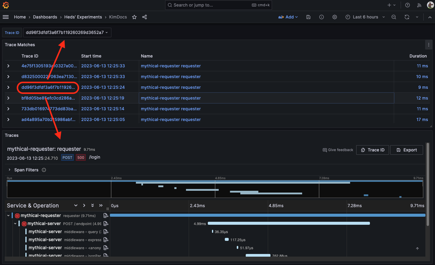

Add TraceQL with table visualizations
While you can add a trace visualization to a dashboard, having to manually add trace IDs as a dashboard variable is cumbersome. It’s more useful to instead be able to use TraceQL queries to search for specific types of traces and then select appropriate traces from matching results.

When results are returned from a query, the results are rendered in the panel’s table.
Use a variable to add other links to traces
The results in the traces visualization include links to the Explore page that renders the trace. You can add other links to traces in the table that fill in the traceId
dashboard variable when selected, so that the trace is visualized in the same dashboard.
To create a set of data links in the panel, use the following steps:

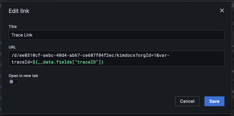

In the panel editor menu, under Data links, click Add link.
Add a Title for the data link.
Find the UUID of the dashboard by looking in your browser’s address bar when the full dashboard is being rendered. Because this is a link to a dashboard in the same Grafana stack, only the path of the dashboard is required.
In the URL field, make a self-reference to the dashboard that contains both of the panels. This self-reference uses the value of the selected trace in the table to fill in the dashboard variable. Use the path for the dashboard from the previous step and then fill in the value of
traceId
using the selected results from the TraceQL table. The trace ID is exposed using thetraceID
data field in the returned results, so use that as the value for the dashboard variable.Select Save to save the data link.
Click Back to dashboard and Exit edit.

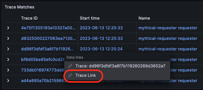

You should now see a list of matching traces in the table visualization. While selecting the TraceID or SpanID fields will give you the option to either open the Explore page to visualize the trace or following the data link, selecting any other field (such as Start time, Name or Duration) automatically follows the data link, filling in the traceId
dashboard variable, and then shows the relevant trace in the trace panel.
