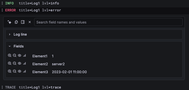

Supported data formats
The logs visualization works best with log-type datasets such as queries from data sources like Loki, Elastic, and InfluxDB.
You can also build log-formatted data from other data sources as long as the first field is a time type followed by string, number, and time fields. The leading time field is used to sort and timestamp the logs and if the data contains other time-type fields, they’re included as elements of the logged record.
The second field is used as the log record title regardless of whether it’s a time, numeric, or string field. Usually the second field is a text field containing multiple string elements, but if the message level (or lvl
) is present, the visualization uses the values in it to add colors to the record, as described in Log levels integration.
Subsequent fields are collapsed inside of each log record and you can open them by clicking the expand (>
) icon.
To limit the number of log lines rendered in the visualization, you can use the Max data points setting in the panel Query options. If that option isn’t set, then the data source typically enforces its own default limit.
Example

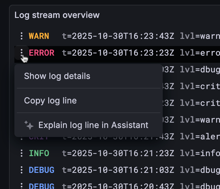

Log level
For logs where a level label is specified, we use the value of the label to determine the log level and update color accordingly. If the log doesn’t have a level label specified, we try to find out if its content matches any of the supported expressions (see below for more information). The log level is always determined by the first match. In case Grafana is not able to determine a log level, it will be visualized with unknown log level. See supported log levels and mappings of log level abbreviation and expressions.
