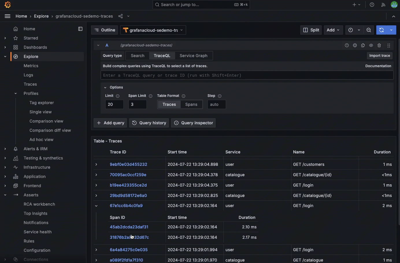

Using span filters, you can filter your spans in the trace timeline viewer. The more filters you add, the more specific are the filtered spans.
Screenshot of span filtering

Use span filters
You can access span filters from within the trace view. You can add one or more filters. The more filters you add, the more specific data that you are filtering.
  1. Expand a trace to view individual spans.
  2. Select a span to view the span details.
  3. Select Span Filters to display the available filters.
Locate span filters in trace view
Query results in the span view update as you select filters.
